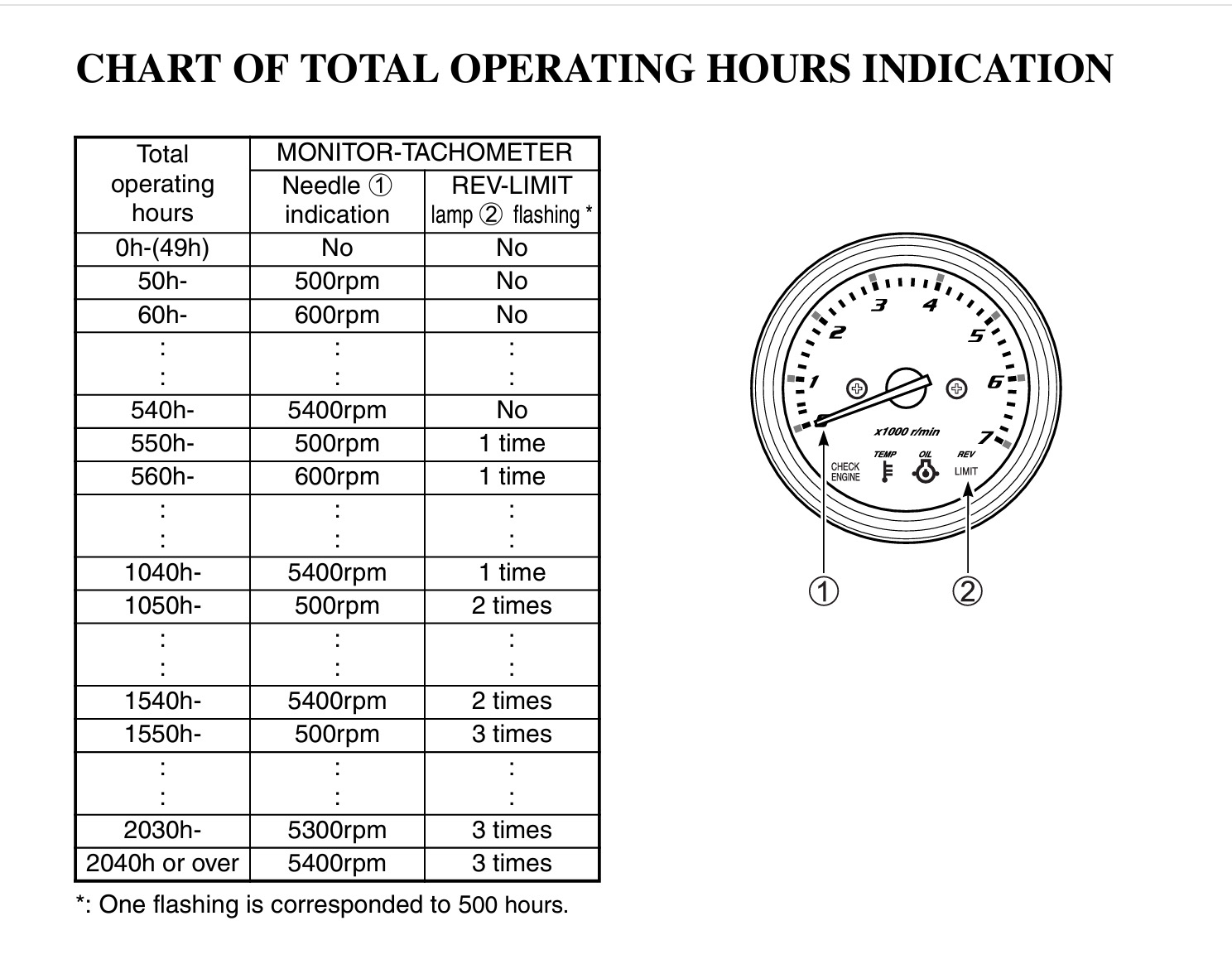

Also, out of curiosity, how do you check engine hours of engine has over 700 hours and tach only goes to 7,000 ?

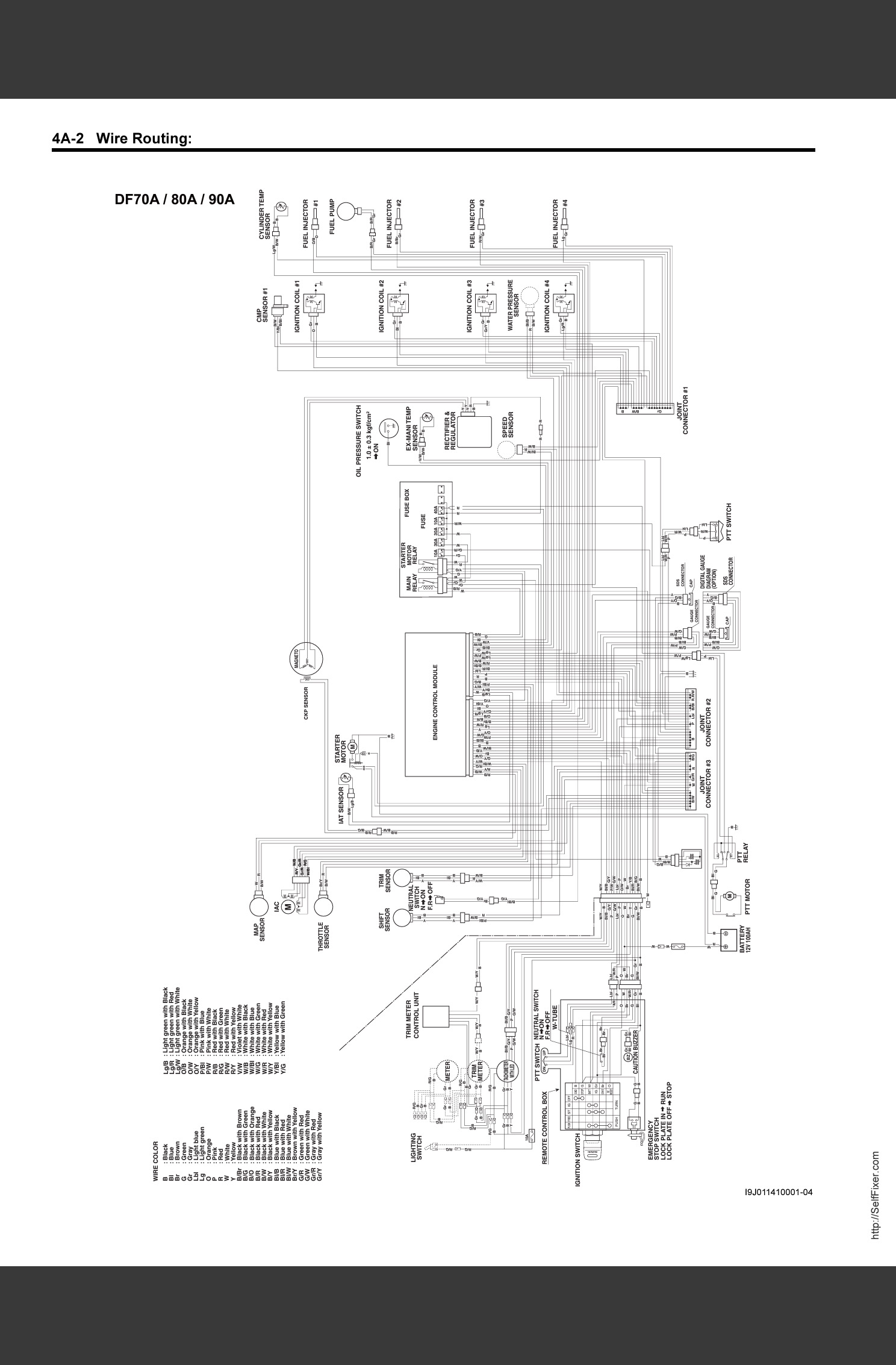

From a 2009 DF90A. When you expand the the screenshot to read the wiring schematic if it’s too blurry send me your email and I’ll send you a higher definition screenshot. It’s not your engine but I’d bet Suzuki has standardized their wiring.
Thanks William. I did not unplug any wiring. The motor and harness came off a pontoon boat and the ignition switch, safety switch, beeper, all attached to a plate that mounted in the console. Nothing disconnected there... Might be a bad beeper...
I’m no electrician but it looks like if you ground the green and give the blue 12 volts it should buzz. Could be a bad connection, corrosion somewhere. Put a volt meter on the blue, turn the key to on(not start) and see what you get for voltage. At this stage you don’t know if the buzzer is faulty or a wiring issue. Did it buzz on the donor boat?
