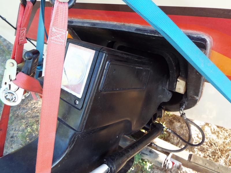

I'll post a pic, its definitly a 300. I received a manual with it and the look is unmistakable. Are they worth anything if I convert to jet. Or should I run it until it dies?

There were 2 models.... HA & HB. HA has a thinner emblem on the side and the HB has a wider sticker.
Inside there are differences in the shift forks too but not that it matters. HB's are relatively more common.
They only made them around 3 yrs unfortunately as it was the end of Chrysler marine inboards.

Heres pics. It looks like it should have a jet, and most others of this model did. I have 3 sets of 460 marine jet systems. If the chrysler transom hole is smaller then a Berkeley then cutting it out is easy. If the hole is bigger then its not worth it. Or I really need a 460 adapter to the chrysler 300 and ditch the jet idea until the outdrive goes. The boat is in amazingly good shape. boat 002.jpgboat 004.jpgboat 001.jpgboat 003.jpg
