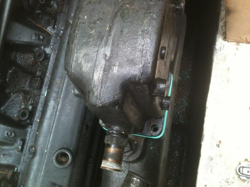

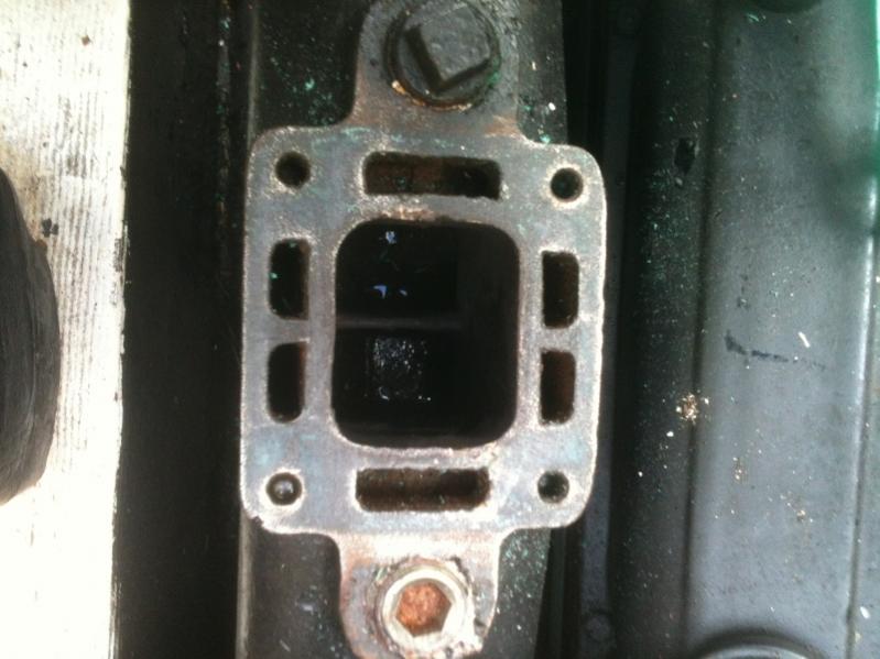

Lastly I let the motor run for about 20 minutes and I noticed that the port exhaust riser was noticeably warmer to the touch than the starboard. Also the water coming out of the out drive on the port side was warm than that on starboard. I'm thinking it's a riser or manifold issue. I did replace the thermostat and I notice that the housing was very rust inside would this have any thing to do with that?
