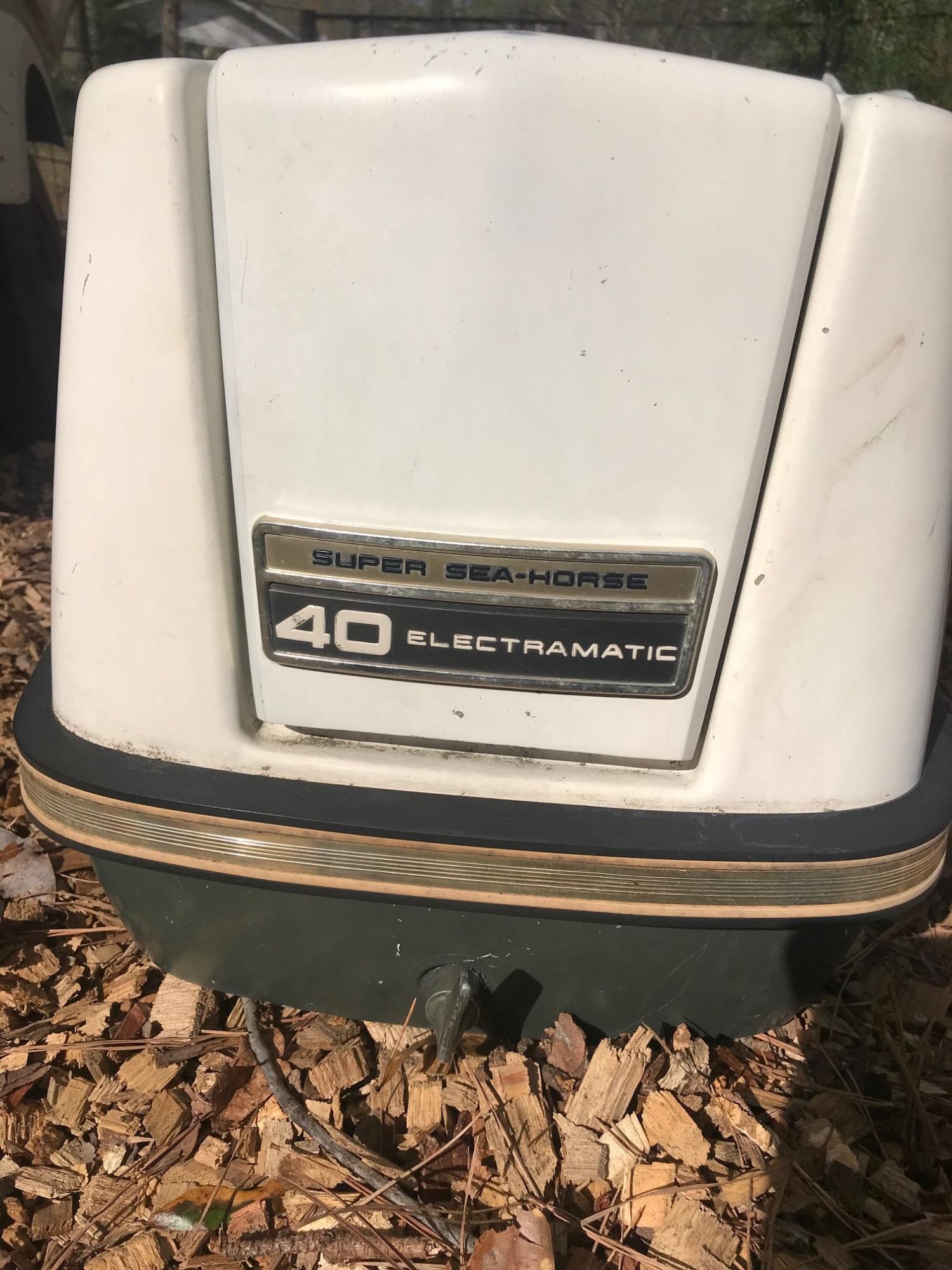

Not new to forums, but to boat and boat engines, so I just wanted to ask if there is anything anyone would do to this engine before putting it in the water. I had a small outboard years ago and I remember making sure to check and/or replace the impeller. I was going to check it by injecting water into the intake and seeing if the thermostat and impeller are working and start there. Other than that, are there some super-need to know items specific to this engine that would be a good idea to check? Without knowing where to go easily on this forum, are there good checklists here that someone could point me to?
Engine starts right up and sounds great.
Oh, in true forum style, I could only upload this one image. I have more.
An ---RKL-30 perhaps.-----Judging by the color it is a 1967 /1968 / 69 model.------An excellent motor.-----Replace impeller, inspect thermostat, change gear oil ( type C / Premium blend ) that is marked for electric shift.-------Make sure the generator and belt are in good working order.----Make sure the " hot air choke " is all in order too.---Do a compression test for future reference.-----Post some more pictures of power head too.

If you had posted a picture of the side of the hood I could recognize a 67 model in 2 seconds.----All the same parts as the 68 / 69 model.----Electric shift is great stuff in my opinion.----The red lever on the control is for advancing the throttle for fast idle in neutral.----Choke is essentially automatic with a solenoid to help with initial cold start.

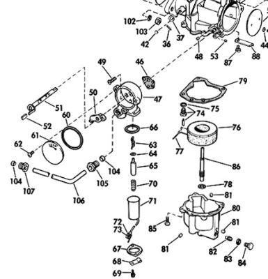

Item #61 that has the bi-metallic spring is adjustable for choke operation.------I used to have a very good feel to adjust those.----I think I have lost that touch.----I have many of those carburetors on hand.-----Just have not worked on many lately !

OK, I forgot that this forum includes exploded views of the engine. So I found all the diagrams I was looking for. Turns out the thermostat kit I have is for a different engine, but it actually looks like a really convenient and easy replacement.
