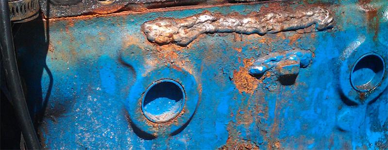

Anyway, once I finally got the 120 running, she started spewing milkshake out of the valve cover breather tube... (Ruh-roh). I shut her down and, sure 'nuff, oil pan had almost as much water as oil....
Took off the manifold and found this:
Well hidden under the manifold and, apparently, not something the previous owner felt he needed to disclose. (If you look under the long weld, you can also see another about 3" long between the plugs that has actually been painted over!)
