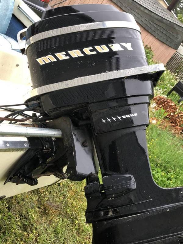

First let me say hi and thank you for your interest in my project.
I purchased a boat with the 1965 mercury 500 50 hp a week ago. As I would find out later in the day the timing belt was snapped. I found 2 of them and just got them today. I installed them and made sure all timing marks lined up. Now this sweet little motor had a set of plugs in it that had never been fired so I was feeling lucky. I keyed it up and cranked away and nothing, So I pulled the number one plug and found that she is getting no spark. I hit the power leads on the circuit boards and found that I was getting 11.5 on one lead and 3 on the second lead with the ignition in the on position.And it looks like I have power in all other areas. So I am now left here scratching my head. Does any one have any ideas for what direction I should now go with it? Thank you
