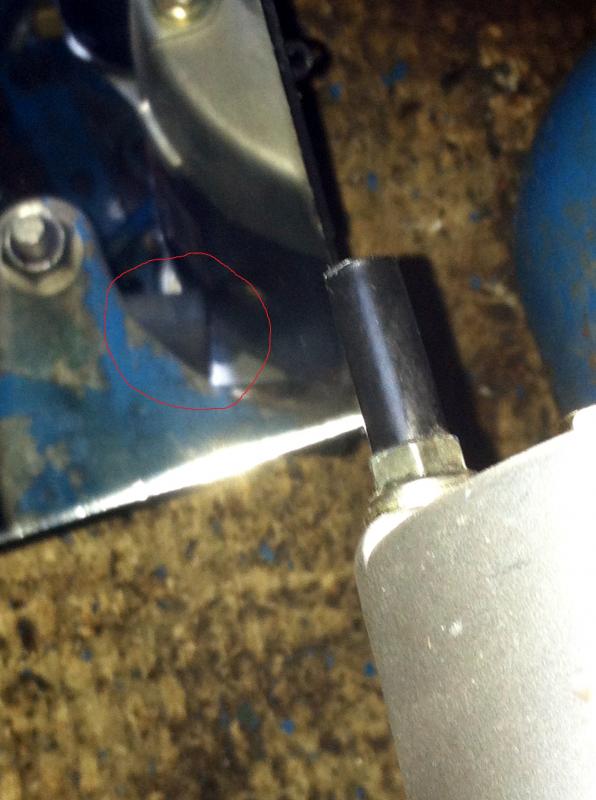

I got two brand new Arco starters. The problem as you can see in the pic is the trunnion just makes contact with the body of the starter so I can't quite get it installed. I looked at the other engine and it's fractions away on that side too. I've only done a very rough/eyeball side to side alignment and so maybe the new strut position moved the engine over a hair which led to my issue.
There's plenty of meat on the bone so to speak so I was thinking of removing the mount and grinding maybe an 1/8" off the end of the trunnion. Anyone else had this issue?

Bob, I can't see what you are asking about via your photo. Also, I am not familiar with the term "trunnion" being used with Starter Motor.
Perhaps another photo and more info.
These are Inboard starter motors.....correct?
You mention "25 yo starters".... did you replace with Bendix style..... or solenoid lever action style?
If you modify the starters, then there goes any warrantee. If this is the case (can't tell from your description), I'd go with the "correct" starters that fit.

The "trunnion" is the part of the Crusader mount that the engines slides side/side on. The flat part that is circled in the pic is the end of the trunnion, closest to the engine block. I verified that these are the correct starters for the 454 Crusader. The other engine still has the original starter installed and it's an 1/8" (if that) from touching too. So, that leads me to believe this is model specific and not something anyone would notice if either the alignment were a fraction to the port side or there was another 1/4" between the stringers...
My proposed fix is to grind about an 1/8" off the end of the trunnion which would do the trick.

Bob: If the rear mount's lag bolts are centered in the stringer, then the engine bed was built correctly. Your approach will be much easier than plugging the existing holes and redrilling new ones. you only have to provide relief on the upper half of the trunnion. I'd be inclined to remove the material using a bench grinder. To ensure no stress induced issues later on, smooth (radius) the edges around the perimeter of the ground out area...

I looked at the pic again and can how it's confusing. I don't know if it's obvious but it's actually a picture of a mirror I'm holding, the only way I could get the pic. The only part of any relevance is inside the red circle. Yes, the Delco starter is exactly what it looks like. I don't believe the smaller ones are on option for the 454's but that doesn't mean that someone else might have them as an option. The Arco's get good feedback so I guess I'll stick with them since I already have them. Now that I know about this minor clearance issue, I'll take care of that in advance on the other engine.
I removed the entire mount and then ground off about 1/2" from the end of the trunnion which basically makes it flush with the bracket. It's impossible to move the engine any further to one side so the trunnion will always be "inside" but won't have any significant overhang. I did it off the boat since grinders throw so many sparks.

Bob, me in blue text..........
Rick,
At first I did think "mirror" but wasn't sure. That makes sense to me now.
