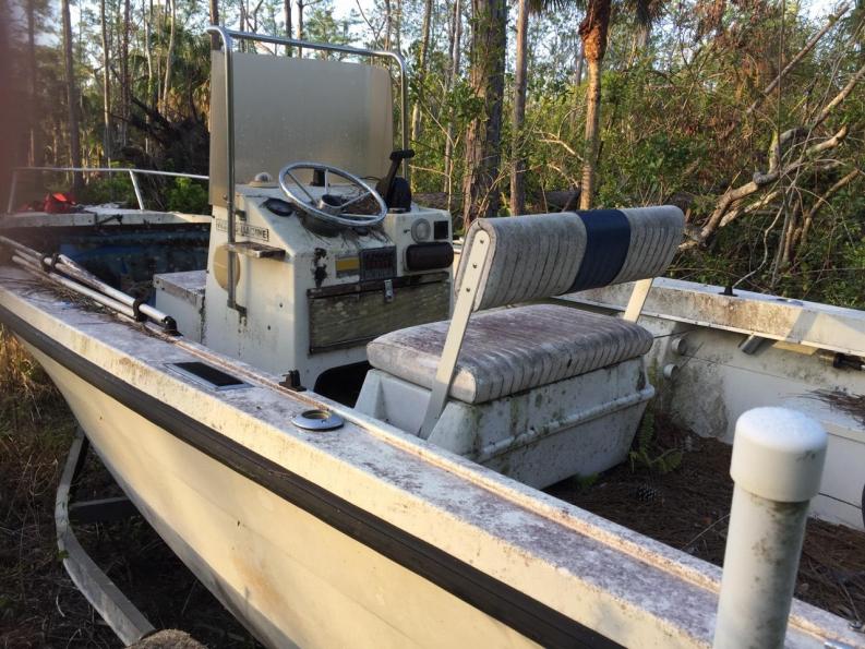

Just wanted to introduce myself as a new member . We live in Naples, Fl. and boat often . A friend of a friend offered my 16 year old son a free boat a few weeks ago to get it off their property .Hasn't been run in 7 years but has title and says it ran fine before they quit using it . yeah right .
it's a 1988 18' cc with a 1998 Evinrude 150 . That is all we know .
Any way we have been working hard cleaning and fixing it up . This weekend we started on the motor . Cleaned out tank , new sender , all new hoses from tank to motor , new bulb , filters . Inspected oil tank and lines , all looked good .Changed plugs, Took the carb bowls off and cleaned them out . Hooked up the hose and started it . Water came out immediately and you could see and smell the 2 stroke oil . ran rough for about 30 seconds and then smoothed out nicely , so far so good .
After it cooled off we pulled the thermostats and the lower unit . Tonight we will replace the water pump assembly and gear oil ( old stuff had no water or shavings in it ) After reassembly we will decarb the motor . The only problem so far is the trim tilt motor is gone and the oil in the rams looks like a milk shake , ugh .
