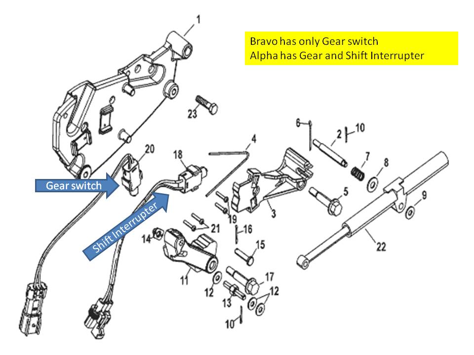

In-Gear switch
If motor things it's not in gear it will cause a misfire to protect the motor
