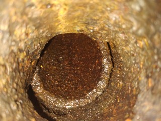

Here is a pic looking up through the 90 to the exhaust manifold/

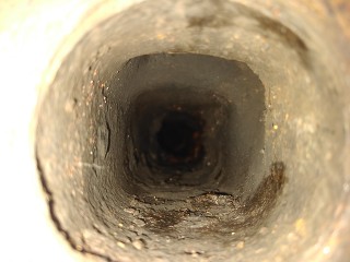

One is looking down the exhaust to the drive, another is looking through the manifold from the removable plate at the front of the engine. The other you can see where I removed the hose. Quite a bit of corrosion that I can clean up. The 90* elbow will probably need to be replaced?
Thank, Jim

The exhaust system's ability to deliver the seawater out with the exhaust gasses, and yet keep things relatively cool, are all part of the engine's Main Heart Beat. If it does not perform correctly, or if it was to fail completely, you can just about count on severe engine damage.

your existing manifold looks pretty nasty, and is why a linked you to the e-Bay ads.
