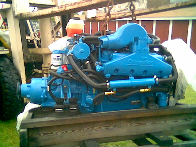

Check with the dealer you are buying the engines from. When I repowered in 07 for an additional $800 each the engines came with rebuilt trans (same as yours)bolted up plumed & wired with new dampers. Everything had been test run. I "just" dropped them in. The trans cores went back on the truck that delivered the engines.

Just took a look at my invoice. It was $950 each for the trans. 10.jpg (in 2007)
