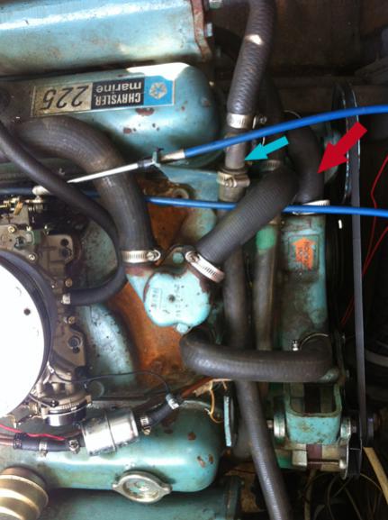

I do believe that the the hose right above the raw water in ( red arrow) goes into the engine. And the hose on the top side of the other port (Blue arrow) goes into the top of the exhaust manifolds. water pump.jpg
Where should the water go first? Should it go into the engine or should it go into the top of the exhaust manifolds?

The Exhaust Manifold and risers now are hot to the touch. Before (when the pump was hooked up backwards) the risers where always cold. Now they are hot but the intake manifold is cool (warm but not hot) to the touch, where that use to get hot. Should I be able to put my hand on the exhaust manifolds and hold it there? How hot should they be? They get hot now even with the thermostat out. Do you think it is the exhaust manifold that is causing the extra white smoke?
J your manifolds are always going to be hot to the touch,your risers should be warm. It's the same as a car,exhaust manifolds are bolted right to the side of the engine,right where exhaust exits but the risers are water cooled so they should only be warm to the touch.

Thanks for the suggestion, it might come to that. For now it runs fine....except for the hot exhaust manifolds and the white smoke with the thermostat in.....even though it is apparently hooked up wrong..What are the dangers of running the exhaust manifolds hot?
Jfreeman, I'm looking at your T-stat housing and trying to make sense of it with the schematic that was posted earlier...., and also looking at the front of your engine trying to envision a single sea water pump adaptation.
I couldn't help buy notice the little automotive in-line fuel filter installed on the pressure side of your fuel system.
This could get you a citation, and it certainly is not a safe scenario, IMO.

Thanks...I know it's just frustrating trying to figure this out. And it ran so good at the gauge hooked up the way it is.
Should it be a flare fitting?
Are you asking about the automotive in-line fuel filter?
We should not have a filter installed in the pressure line from the fuel pump to the carburetor.
The only fuel filters that we'll see in the pressure line, will be on some of the FI systems, and these are designed for this.
Your main fuel filter will be in the suction line, up-stream of the fuel pump, and just after your anti-siphon valve.
Your carburetor may have a small screen within the fuel inlet fitting. Pull this apart, and check.
In addition to the automotive in-line filters not being legal, their square area of filtering media is just too small for our usage.
Add to that, that these are often 20 to 30 micron, or even smaller.
If there is no primary filter, these can become restricted very quickly.
They actaully have no place in a marine application.
