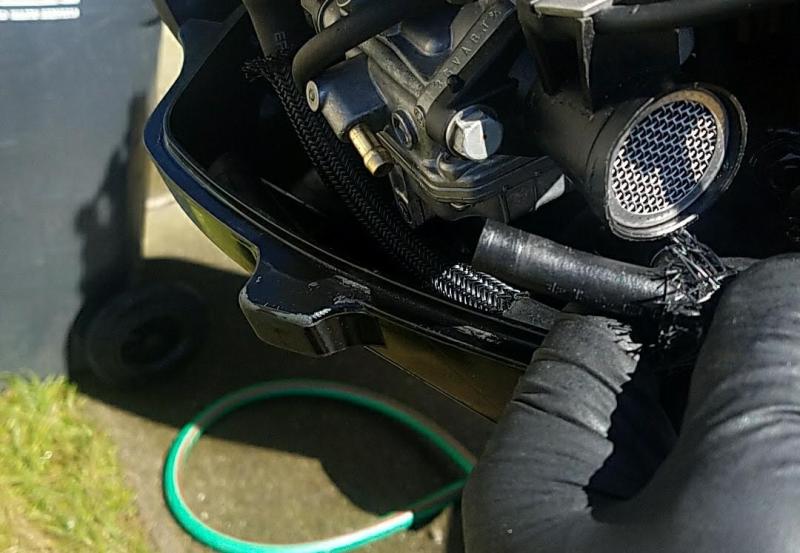

I tried to start the motor before everything with no luck and the same symptoms. I disassembled the carb already and dipped the pieces overnight as well, but I did not rebuild it (only changed the gasket for the float bowl). Inside of the tank starting from the fuel tank:
- Hose leading to the gas switch was fine and then to the filter was good (Sorry not sure if that is what its called). I took both hoses out and they were good, but from that filter (?) to the carb there was no fuel in the hose. When I took out the hose connected to the carb there was nothing nor was there anything from the drain on the carb. Is this right? Sorry for the newb questions I'm new to all this!

Can you blow threw that filter either direction after removing it? with fuel line off carb. what happens when you squeeze primer bulb? Have you tried a straw full of fuel mix directly into carb.or spark plug hole??
The filter is a pain to get to there is one bolt on there that does not want come out and is hard to get to. No primer bulb on the mercury I don't think there is. When you say feed fuel directly into the carb where should I feed it in to? The intake or the fuel line? Should there be fuel inside the hose that goes from the filter to the carb when I open up the fuel switch? There isn't any in there when I take it apart. Sorry for all the questions... thank you so much for your advise!
