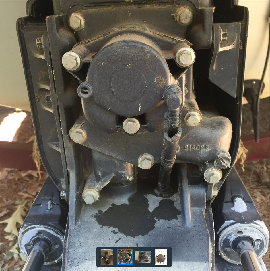

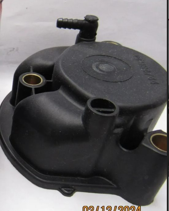

I damaged the impeller housing on OMC King Cobra Stern Drive. The housing has a small hose barb on starboard side of housing which vents water to the lower part of the outdrive. The only ones I can find have the vent on the port side. Since the impeller acts as a positive displacement pump does it matter which side the vented barb is on. The housing is obsolete and I cant find it anywhere. Could I use something like the posted picture? I have included a pic of mine.

I for got to upload picture of part number 984745 showing vent on the port side of the housing.

The one you posted just above this post looks like the standard dog clutch Cobra impeller, there's no way to know if it will fit and work right.

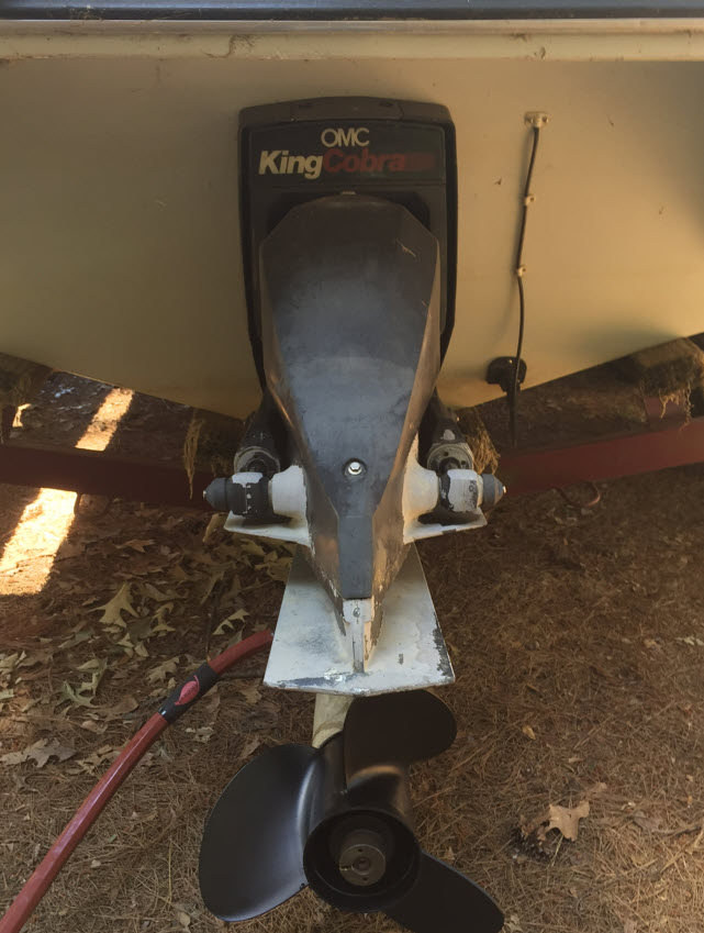

Agreed! I dont think it’s a cone clutch. If I understand correctly, I think the cone clutch has a bit of a hump on gear case, I do not. My exhaust is through prop
I ordered a kit off Amazon that should bolt up correctly but just not sure if having that barb on port side will work. As long as it pumps water, I would think it should work. From my service manual, looks like the barb feeds water to the prop hub to cool it.
My plan is to put a long hose on it and see if I get a strong stream of water when boat in water. It’s all I k ow to do at this point.

3 years ago I had this same issue, the cage spun in the original housing. I just saw today that my boat was getting up in the 200 degree range while heading back, so I knew it was time again. Started looking for parts and of course, this housing is still not availible, and I came across this forum with others having the same issue, and the thread isn't 10 years old!! I'll tell you what I did last time, use this advice at your own discretion, it may not be the right way to do it, however, when you're SOL, you'll take anything that will work, and i did it when you could only find $200 kits, now that theyre about $60-$80 and reproduced, ill do it as many times as needed. I am getting ready to do it again, so from what I remember, I bought a 92-95 KC water pump kit with housing to see the difference. I found that the 2 top bolt holes line up with the new housing but the bottom is off by a bit, it could have been worse, and not even been close, so I figured with this fortune, I could modify it. So, I decided that I didn't really have a choice and I Drilled/wollard out the bottom hole to get the bolt to line up, then I used some RTV and a sealing washer on the bolt to take up the space in the now oval bolt hole and get it to seal. This time around, I will probably use some water weld instead of RTV. It will probably be disagreed upon that this should be done, but what else are we to do if they never reproduce the housing? It worked solidly for 3 years, so I'll do it again, as many times as needed, otherwise, we are screwed.

There wasn't, until the cup spun again, giving me a small hole in the housing.
Just as suspected, impeller cage/impeller issue. I always make sure this thing is in the water fully or that the water is flowing from the hose, but oh well.
