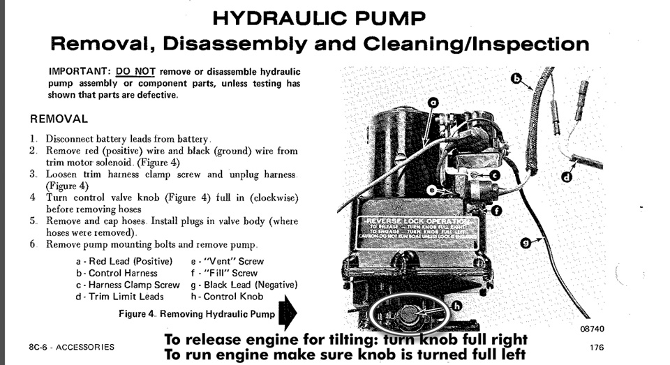

I am changing my powerhead on motor , started outside then I picked it up to back it into the shop , now my new head came in and I need to get the motor back down and I have everything unhooked, I cant find a screw to release anywhere , please help
If this is the external ram type with the pump in the bilge just tilt the motor onto the lock and undo the bolts that hold the rams. Use the reverse lock screw to release for up. reverse-lock-PTsmall.jpgIf it's the external type ignore this.
