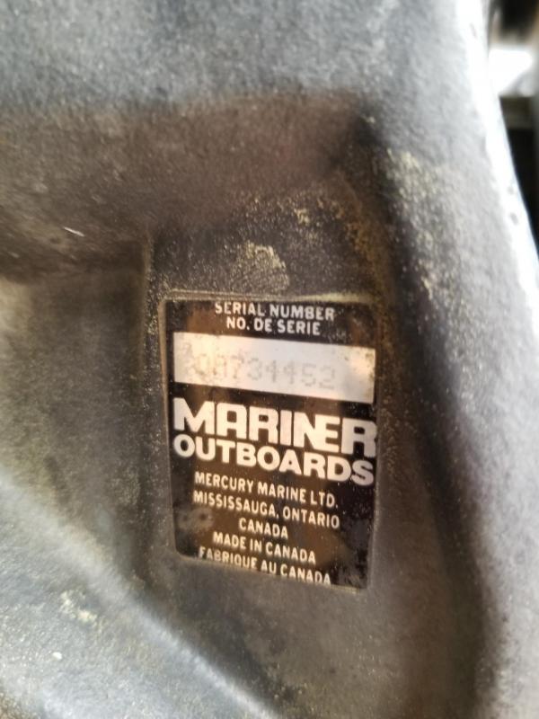

I recently purchased a 1986 starcraft bowrider with a 90 hp mariner.
The serial number on the motor is 0A734452. From what I can find I believe it is a 1985 3 cylinder, but not positive. I can find a range of numbers, but not my serial number exactly. If you could help me out with the year and possibly a location I could find a manual, it would be greatly appreciated.
Thanks in advance.
Hi sorry for late reply, trying to figure out how to upload picture. The list I looked at was on a manuals site so I was not sure it was right.
I think it is a 3 cylinder. Is there a way to email the pictures? I cannot seem to upload them, I think because they are to big
0A731673 was the first production number (serial) from the Merc plant in Mississauga Ontario in 1988.
So you "minimally" have a 1988 model and more probably a 1989 since the plant was being scaled back and wasn't producing "thousands" of motors a year.
