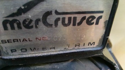

I cant seem to be bale to figure out what I have for a sterndrive and need help identifying it, attached are some pics of the numbers on the drive. All help is greatly appreciated. Thanks.

Generally the MC1 has a lifting eye on the top cap The R has a flat top and a rounded cavitation plate (the one above the zinc tab)
the MR /Alpha has a flat cap. and a squared off cavitation plate
