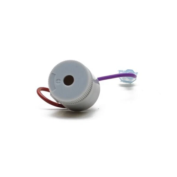

The engine/drive manufacturer isn't usually the source of the alarm buzzer, that's usually part of the harness installed by the boat manufacturer and they usually put it under the helm. It's often similar to the part in the photo- doesn't matter if it looks the same as long as it does the job. It's usually a piezoelectric buzzer.
Don't be too surprised if it has been removed, a wire has been cut or it has been covered with tape- I have seen those on boats and read recommendations to cut the wire on a boat user forum.

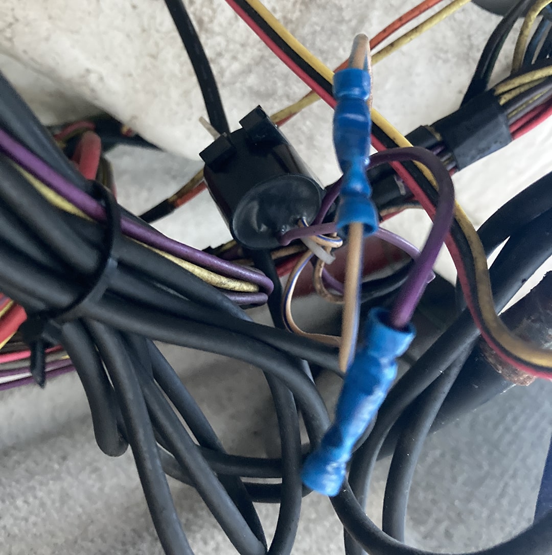

Thanks @jimn, you were correct and found the alarm lurking under the dashboard. It's been completely disconnected, so the alarm will never sound...
Cool. I worked on a boat that had the wire disconnected, by the boat owner. It was a Regal Rush with 90HP Mercury jet drive and he cut it because he didn't like the sound but that was supposed to tell him that the 2 cycle oil reservoir was empty, so he scattered the powerhead. Good sized holes in the sides, connecting rod parts, roller bearing parts, linkage and oil all over the engine compartment. He didn't like the quote for the repair so he complained to the right people and even though he did it intentionally, the covered the cost of the powerhead. He didn't like the labor bill, but he screwed us out of the money for the parts, so.....
I connected the alarm back up today and it sounded as soon as the ignition was activated - constant. I presume that's why the previous owner disconnected it, rather than finding the problem. Or is it supposed to do that? Before I go looking for a problem that doesn't exist :unsure: lol
It is suposed to do that. No oil pressure.
