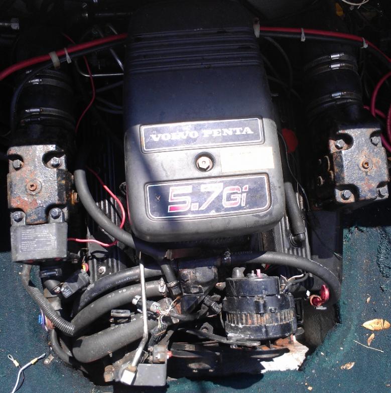

See attached pictures:
1- I cannot locate a data plate on the motor itself to identify a serial number to assist in cross-referencing. My buddy hasn't been able to make it by, but told me it should be on the front of the motor somewhere - well, I can't find it. If someone would be so kind as to
review the picture I provided and:
a- Stick it in PPT or something and draw an arrow to where I should find it....:confused: Yes, Barney (Fife) style.....
b- possible ID/verify the motor model for me by inspection of the pics.

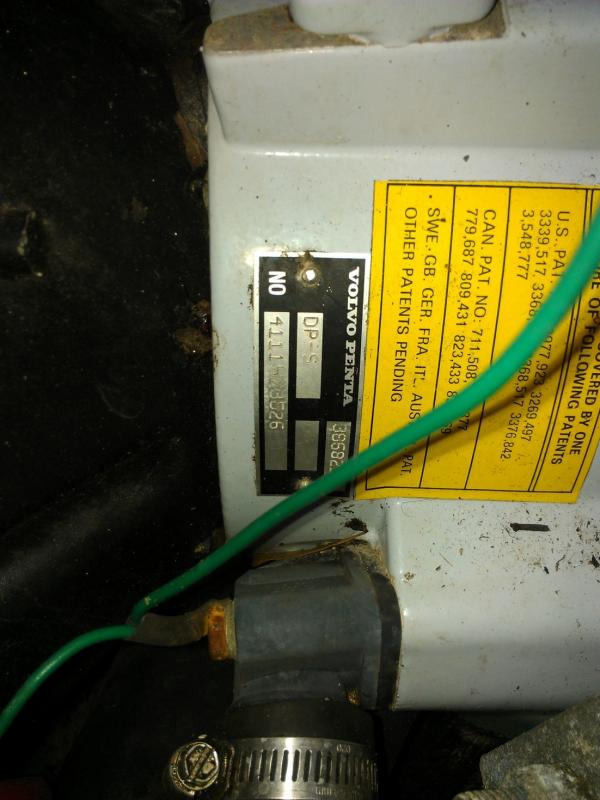

2- I did identify a data plate on the transom. A picture is provided for clarity. I did find several numbers on this data plate.
Can someone:
a- clear/confirm what exactly these numbers are (engine/drive serial/model #'s??)

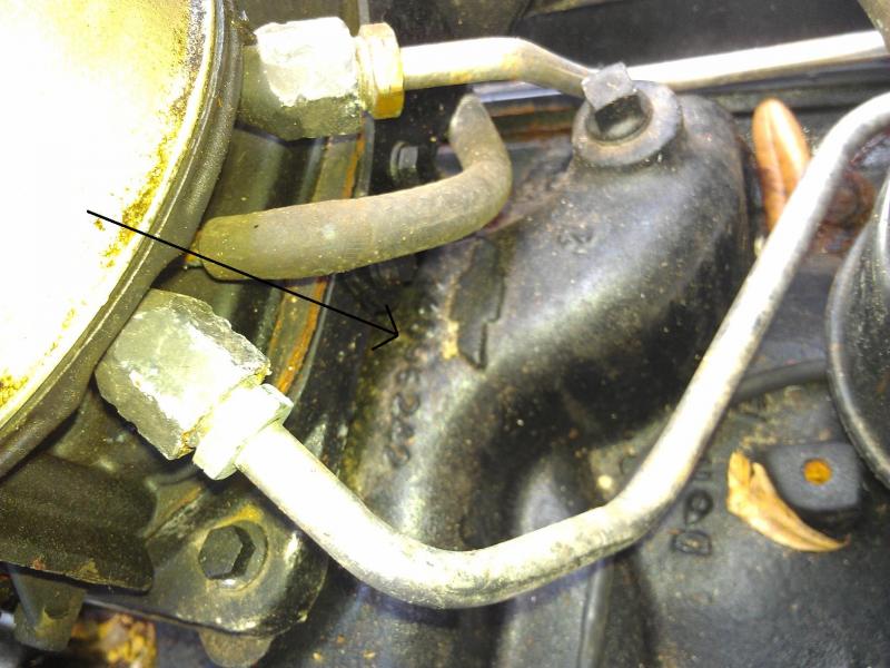

3- also located a raised number (forged) on the top of the intake manifold next to a Chevy symbol. See picture. Does this mean anything?

After posting above, I went back to my SECO manual to dig through it some more, and it did give some additional information on location of the data plate. I could still not locate, possibly hidden from view. The way it read (could have been more specific with better pics), I primarily was looking at the upper left corner of the top view pic, on the valve cover, as well as below on the block. Too many hoses in the way and couldn't see much even with a mirror.
