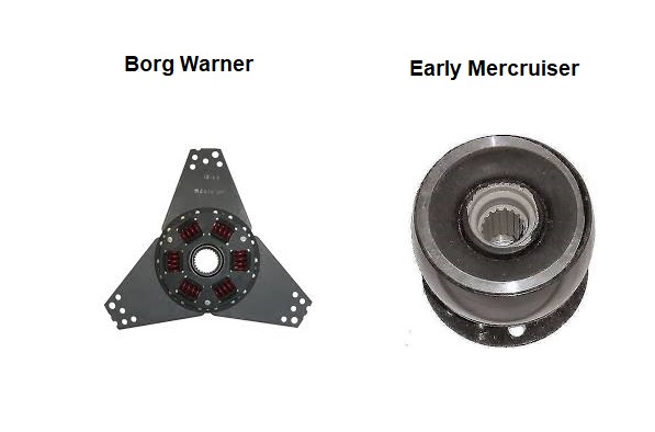

The AQ260A used a Borg Warner drive coupler that was attached to the outer bolt pattern of the flywheel friction face.
You'll need a Mercruiser rubber hubbed drive coupler that will fit the AQ260A 2 pc rear main seal crankshaft flange.
You will also need to go through the drive coupler/engine alignment procedure once the AQ260 has been installed.

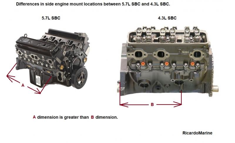

The side engine mounts for the AQ260 will be further forward. You will need to make sure that your stringer mounts will accommodate the further forward mounting.

Here is an image showing the differences in location of the side engine mount bosses between the 5.7L and the 4.3L .
