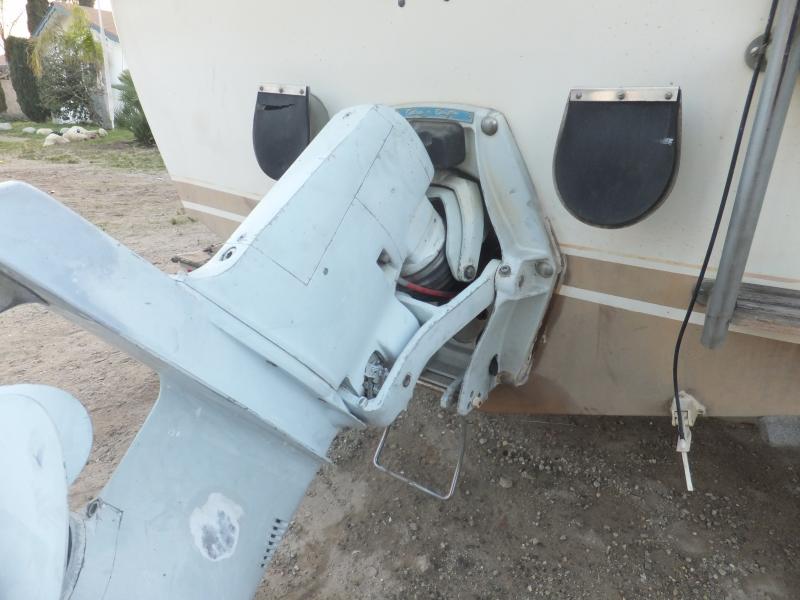

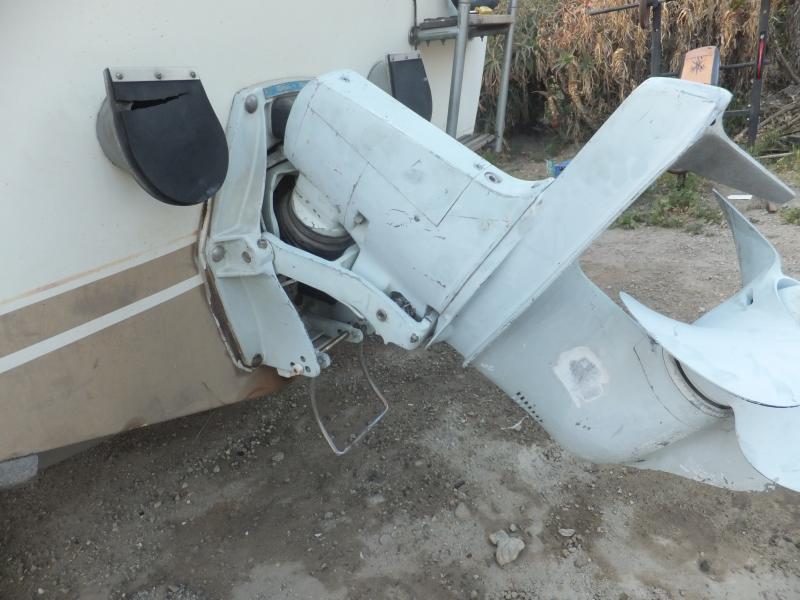

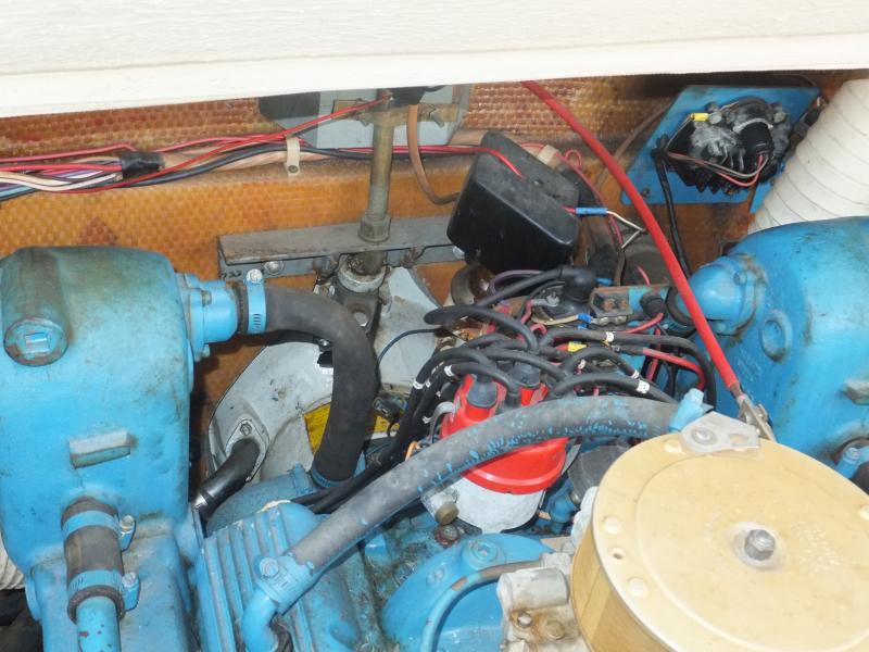

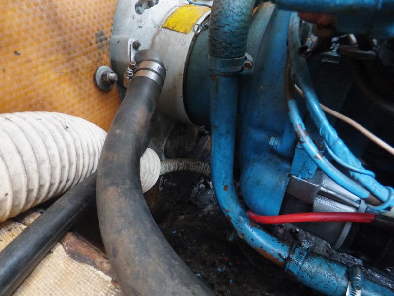

OK... that sure helps, but we're not quite there yet.
It would sure help to see the engine, and perhaps more of the drive.
The drive is definitely Volvo Penta, and is very likely a 250... but I'd need to see more of it.
The OEM exhaust has been circumvented and is now what's called "Thru Transom" exhaust.
Since the previous owner did this with the exhaust...., he may have also circumvented the OEM sea water path, and did a thru hull pick up system.
If so, that may explain why you're not getting any cooling water.
This is why more photos would be very helpful
FYI: by running witout cooling water, you have probably and completely damaged your sea water pump impeller.... and perhaps blistered the interior of your rubber exhaust components.
Do you by chance have any friends who are experienced boat owners who'd be wiling to help you????
Meanwhile... more photos... the more the better. :D :D

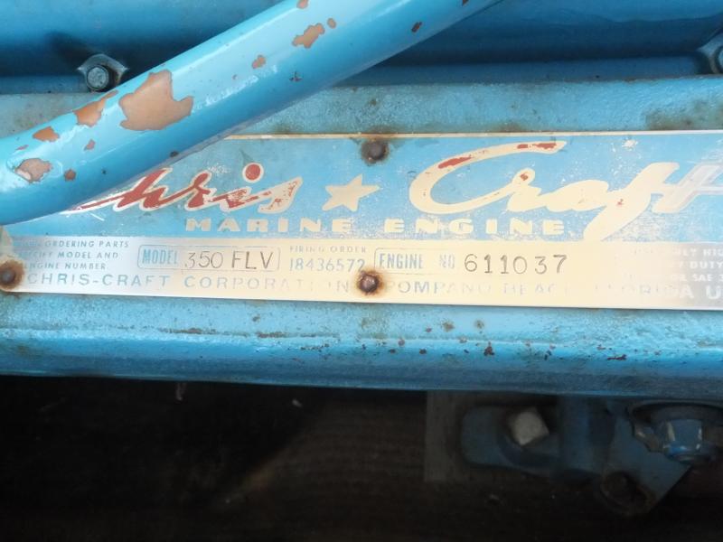

Now we're getting somewhere.
The drive is a 250... unlikely, but possibly an early 270.
The fill port in the Intermediate and inserts in the suspension fork tell me this.
The old Chris Craft stuff doesn't tell me much. I'd not replace any of it with CC parts... especially the exhaust.
I'd go newer and universal if need be.
OK... the OEM sea water connection is being used. The water neck fitting at the drive is probably corroded and is failing. You need to replace this part.
