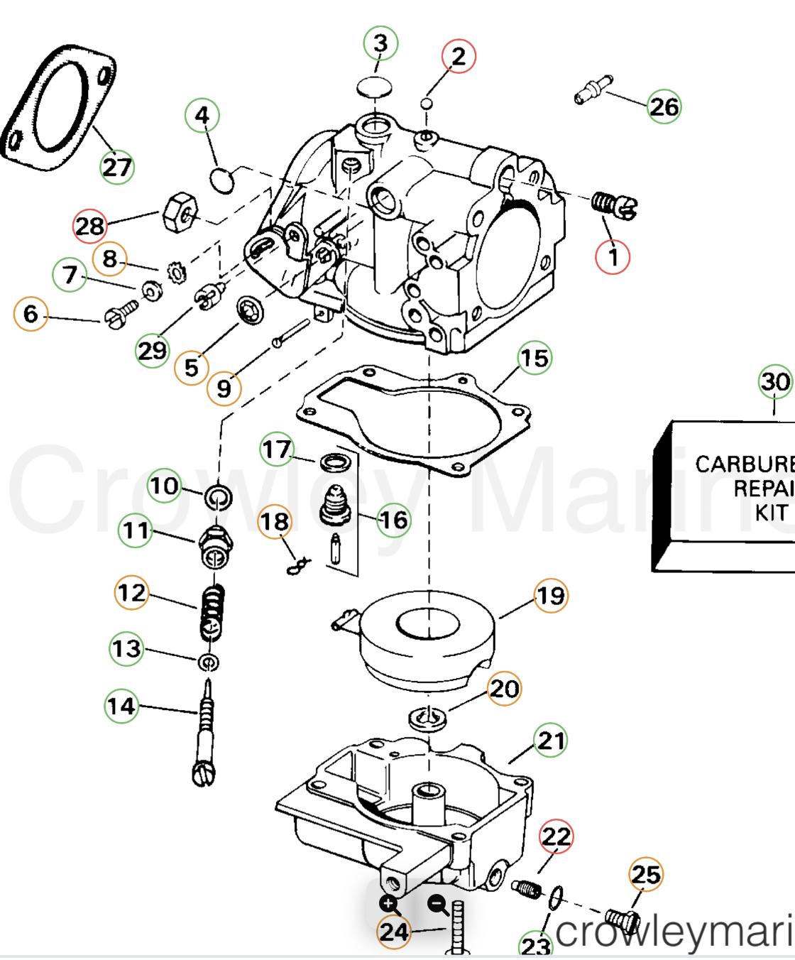

New to outboard repair and I have some naive questions about how carbs work. There are two gas(?) lines that connect to the carb. There is small hose that comes from the primer syringe and connect to a small nipple at the top of the carb (#26 on the image below). When the engine is running, gas squirts out of the hose when disconnected from the carb.

After further investigation, I've discovered that fuel is squirting out of the primer hose because it is coming from the hose coming from the intake manifold, which tees with the hose coming from the primer. So maybe the reeds? Maybe something worse?
Reeds are rarely an issue.---But if a seagull feather is stuck in a reed ,that might be an issue.-----Post a video of what is happening.----The manual primer pulls fuel from the carburetor float bowl.----It injects it into the carburetor throat and intake manifold via small hoses.-----How does this motor start and run----Post a video?
