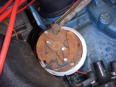

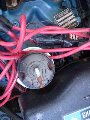

Anyone using these distributors look at mine after two seasons. They failed miserably they were both so rusted I could not remove the rotor screws I had to saw and crack the rotors off in order to get the screws off. the springs actually rusted so badly that they fell apart. The advance weights were so rusty they froze in place. I am so discussed with Pertronix products. I thought I was upgrading my ignition (not)! Pertronix dosn't even stock parts they make them on an oder by order basis. How stupid is this? I emailed Pertronix and got an email back saying that I would get a response within 48 hours! Over two weeks and no response! I don't know if other distributors are any better but I am disgusted with these poorly made distributors! My original distributors over thirty years old had no rust issues! What kind of crap does Pertronix use to build these so called marine distributors?

Yuck! Mine get that way if I don't remember to keep the engine room hatches open all winter during lay up. (I now put a large, highlighted in yellow sign on the salon door saying "Open Engine Hatches Dummy!" to prevent that.)
Rust can be removed, parts lubed, and made good again. A bunch of work, however.

Man, you must have been suffering from some performance loss with no advance taking place. Wow!
Question: Are these actually Marine distributors? Or are these Automotive distributors with the vacuum advance removed?
I don't typically see Marine distrubutors with the advancing mechanism on top like this!
I'm not a supporter of any Pertronix products. All of their electronic systems use Hall Effect triggering, of which I just can't bring myself to use.
Having said that, I don't necessarily think that the rusty flyweights are a Pertronix issue exclusively.
I'd be more inclined to think that you have an engine bay moisture problem.... and you are likely in salt water...yes/no?

Yes Rick they are in salt water,and these are marine distributors(at least that is what pertronix sells them as) my last boat was in salt water for ten years with no rust issues. The original distributors on this boat were in salt water for four years with no rust issues.
Even the rotor ends were rusted,I have never seen this on any distributor. Some of the bolts holding the ignition were even rusted while the others look good as new.The boat wasn't running right, at first I thought crossed a wire when I replaced the valve cover gaskets, but that wasn't the case. That's when I took off the caps. Even the springs were completely disintegrated. Nothing else on this boat has rust issues except the distributors. I still think these components should not look like this after two seasons. For now I will replace the caps rotors and springs. When the ignition goes I will replace them with Mallory units. The distributors run pretty good , for now I will use them. I will spray them with corrosion /lube spray.

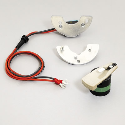

I know this is a day-late-dollar-short comment but, for those who might be considering going the Pertronix route - unless your OE distributor is completely shot, their electronic conversion kit is a better option, for a marine application, than their complete distributor. It only adds a couple of components (primarily plastic) to your, legitimately-marine, OE distributor........and works very well.
I beg to differ.... but you covered yourself by adding; "unless your OE distributor is completely shot"......
The thing with the kits is that we tend to install these and pay little to no attention to the wear that may have occured to the OEM distributors.
When these old distributors become worn, it may affect the advance mechanism and curve.
Rusty and weak flyweight springs will allow advance to come on too early.
Worn shaft bushings may also affect the performance.
Be very careful when using the retro-fit Pertronix Hall Effect kits.
Actually, I think I also "covered myself" by stating "their electronic conversion kit is a better option, for a marine application, than their complete distributor". The discussion is/was specifically about Pertronix and their products. I wasn't presenting a case for buying a Petronix conversion kit over a Mallory marine or other legit marine replacement. Rather, I was comparing the Pertronix options (note "for those considering going the Pertronix route"). I brought up the conversion kit, in part, because in his original post, Bob suggested that his OE's were in better condition after 30 years than the Pertronix were after 2.
I respect your beg-to-differ but, of the two Petronix options, I would consider a conversion (into a OE distributor that isn't shot, as stated) to be a better option, and less of a dice-roll, than what we see in those pictures. Where you're against Hall Effect (and I don't disagree), I'll call it lesser-of-two-evils argument.
At the end of the day, Pertronix products, despite what they say, clearly haven't hit the marine-grade level. So, if someone, for whatever reason, were to choose them as the electronic conversion option, less is probably more.
