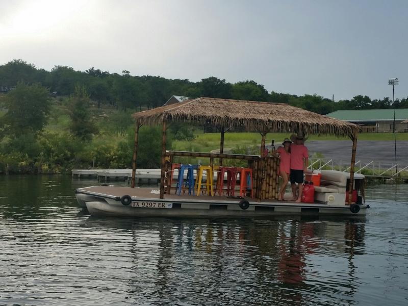

I would like my wife and son to be able to drive this reliably but as it stands, I am the only person who can keep it running. I guess on a positive note, nobody's can steal it! BTW - I converted it to a tiki bar. Pics attached. Enjoy!

EDIT: Love the Tiki look......but your pontoons look VERY low in the water to my eye. Having had a pontoon boat in the family, I know they leak over time and really need to be drained (and just as often had un-noticed leaks welded). You might want to have that looked at.

The pontoons are fine. Just too small! The issue is that I widened the deck by 2 1/2 feet with steel and the roof frame is out of steel. I would have loved to done it all in aluminum, just resource and skill limited! Just too heavy!!! The instability is part of the whole tiki (and rum) experience! ��
