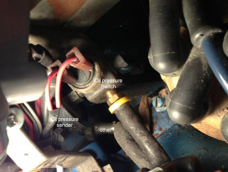

Also, on the rear of the engine, there is an oil pressure switch, and an oil pressure sender on the same manifold that's fed by a braided line.
The sender is for the oil pressure gauge.
If there is also a switch there, it may be for an electric fuel pump relay, or perhaps a low oil pressure alarm.
There is also another sender on this manifold that has 2 wires going to it. In looking at the wiring diagram under the engine covers, the vessel may have had the optional alarm systems. but I don't see anything on the instrument panel that would seem like indicators for alarms.
With two wires it may be for an over-temp alarm.

OK, I looked at it some more last night, and the additional senders must be for alarms. I did take some pictures. the one below is the oil pressure senders. I labled the sender in queston "other". I ran into some issues trying to post more than one image. I also have one of the temp senders, and the coolant tank. I do believe, that the thermostat must be under the coolant tank.
Hard to tell by the photos.
I'd certainly recommend that you rid this of the push-on hoses.
Either build yourself a brass manifold affair......, or find another means of connecting these into your pressurized oil system.
Or.... have some custom made higher pressure hoses made up.
