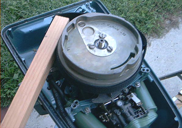

I assume you mean flywheel nut. And that opens a whole 'nuther topic. To do this job right, you need a strap wrench to hold the flywheel, a flywheel puller to get it off, and a torque wrench to put it back on at the proper tightness. There are other ways to do it on the cheap, many of which will cause damage. Redneck way of getting the nut off without a strap wrench is whack the nut wrench handle with a hammer in the direction it needs to turn. You can put it back on the same way, guessing at the torque, but it is almost guaranteed you'll get it wrong. Hey, you are learning, so you might as well learn to do it right. Or deal with the damage you did.

To get the nut off, I have a cheap thing that is longer than a spark plug and threads into the spark plug hole, (can likely get at a chainsaw repair shop.) When the piston comes up, it stops when it hits that thing. It is easy to loosen the nut then......IF IT WAS PREVIOUSLY TORQUED PROPERLY. Rarely have I found that this little spark plug hole tool will not do the job. A small flywheel/gear puller is cheap too. Have you got a Harbor Freight in your area. Then go get some good quality 1/4" NC bolts about 2 1/2 inches long with strong flat washers.....will need 3 sets. You can then get off the flywheel to replace the coils, etc. To torque the flywheel back down is pretty easy. We will help you find proper torque specs and you will need a torque wrench that uses one of your 3/8" or 1/2" drive sockets. Torque wrenches are cheap too. Check Harbor Freight too.

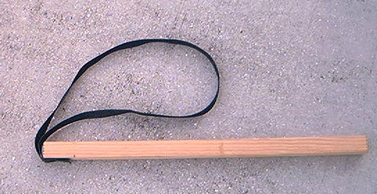

You can make a strap wrench that is better than anything you can buy. And virtually free if you have the materials laying around. Take a piece of common 2 x 2 lumber and nail a piece of nylon strap to it. Will not slip on the largest motors made.

Nice, Gator. I'm gonna make one, got some strapping and screws with a nice piece of red oak. Its never to late to teach an old dog new tricks. I suppose an adjustable strap could help make it more versatile too. Just look around the basement, wife Raquel collects bags......she won't miss just one strap....right?
Look closely at the picture showing it in use. See how the strap doubles back on itself to compensate for flywheel size? Shown on a 5.5hp, same strap fits a 40hp.

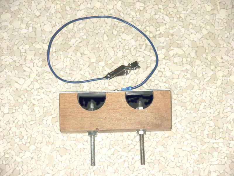

Here is your spark tester.
Just two bolts with 2 nuts each to hold them in place. Just screw them until they are about 3/8" apart from the top metal piece, or whatever you are going for. Put the spark plug boots on the bottom end of the bolts and clip the alligator clip, that is attached to a piece of aluminum or steel, to a good ground on the engine. A little electrical tape backing it so you can see the spark good. It works great.
If I had to make another one I might make the wood a little longer on the left side so the holder can hold wood without the fear of touching any metal. These things put out high voltages. Since someone needs to pull hard on the starter rope usually it requires someone else to hold the spark tester.
As for the home made strap wrench. Most of the nylon I came across seemed to want to stretch so much under the very high torques these things require, so I used an old outdoor electrical extension cord for one of mine and it had no problem holding the flywheel in place while I unscrewed the center bolt and when I torqued the bolt back down again.
Nice tester and adjustable. I like that dark chamber idea. How about an old serpentine belt for the "Gator" strap wrench?
