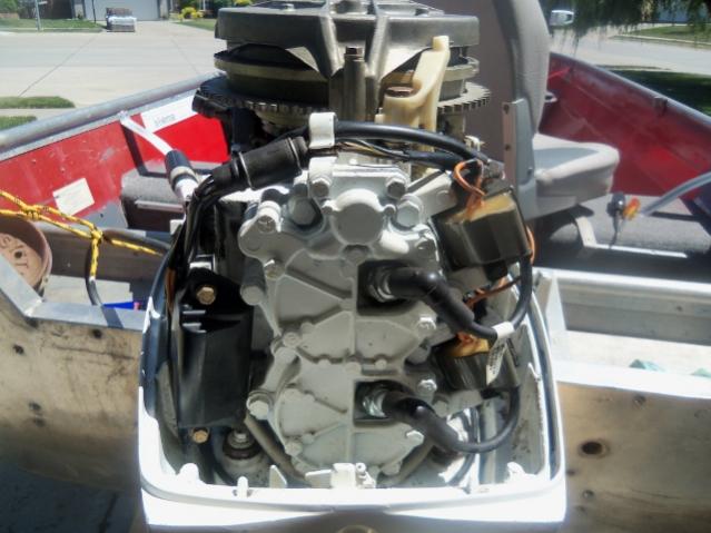

There is just a wee bit of water coming out of the " pee hole " most of the cooling water goes out the prop with the exhaust.-------The " pee hole " can be blocked with weeds / mud / debris and the motor will run cool just the same.
