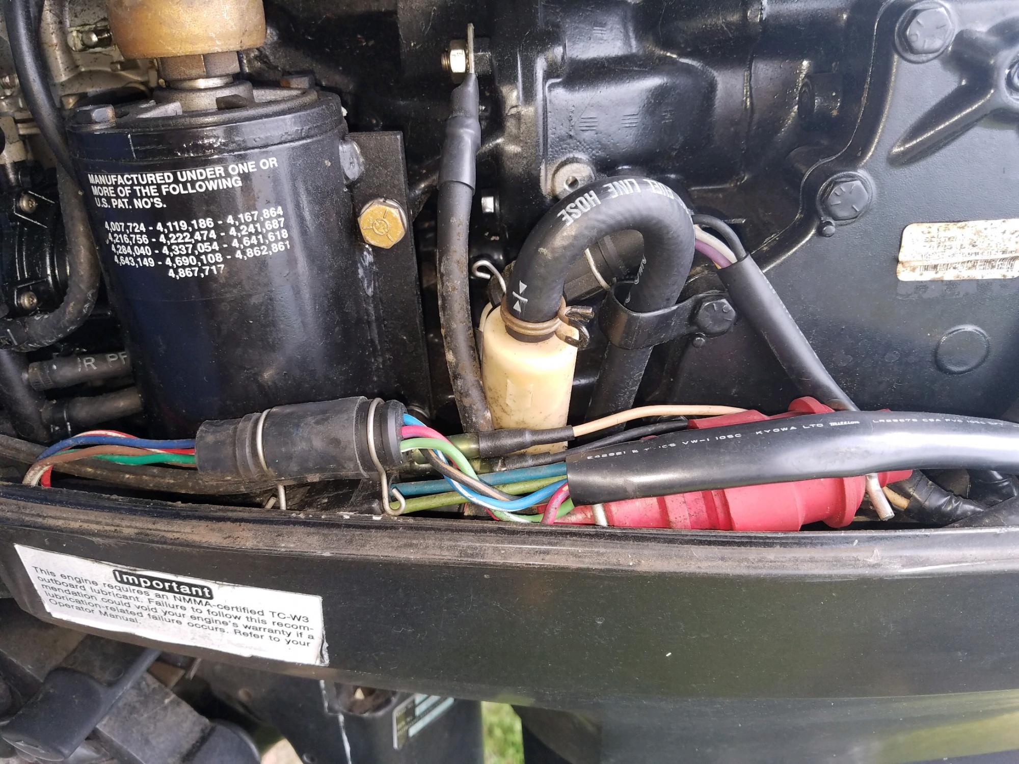

The serial number on the powerhead matches the bracket. The top photo below is the 1993 40hp the bottomthe 1996. 1993_40hp.jpg1996_70hp.jpg

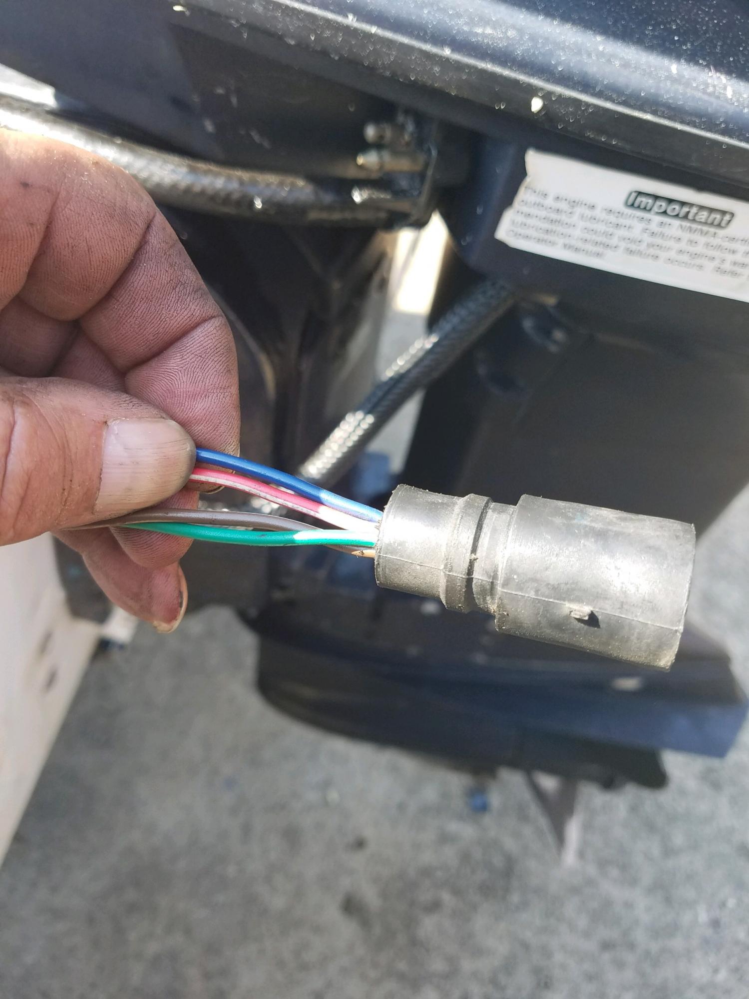

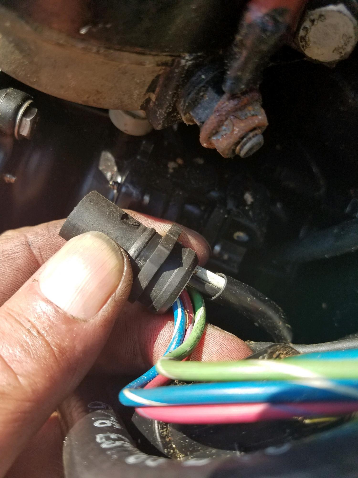

Below are photos of the wires on the connector. The control side has four wires and the 70HP connector has 5 wires.
Can anyone tell me if this will be a problem.

Those are tilt and trim wires. There should be wires coming out of the T/N/T motor and some coming out of the relays. If your 40 did not have tilt and trim you may need the separate harness for it.

Good advice. Also be sure to clean up those connections I see in the background.....any grounds and open posts. Be certain to get some anti seize on stuff and dielectric grease for your plugs.
