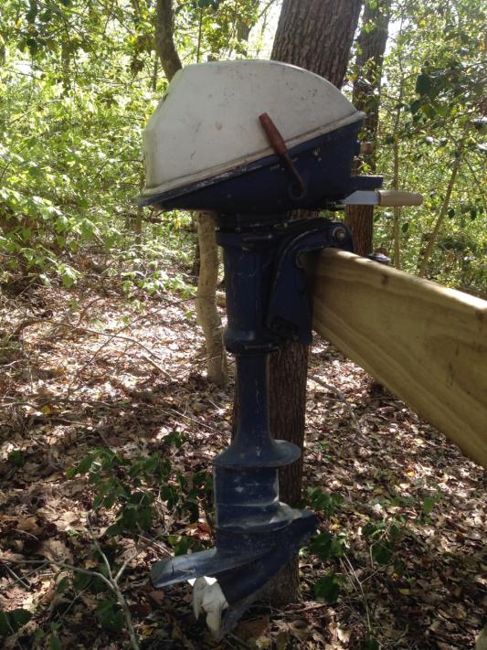

I convinced a friend to sell me this motor after he upgraded to something newer. I never had a gas motor for my john boat and figured this was an opportunity to get one. Life got in the way and the motor has just sat for about 6 years in my shed.
Now I'm trying to identify what I own and what it will take to get her running.
I believe it is a 70's era Evinrude. If I can get the pictures to post I'll put them up here too.

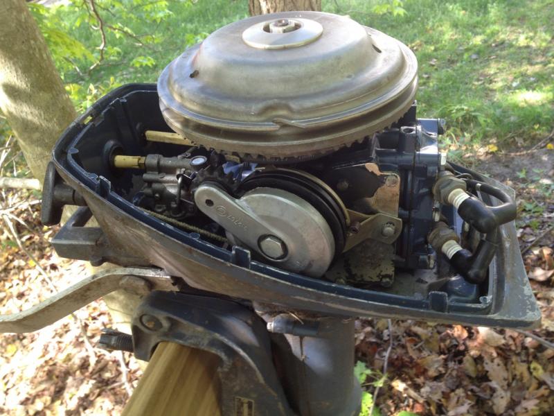

I should add, I pulled the plugs. They looked good; "nice" color, not rich or lean. But that was from the last time it was run. Not sure how much that can change just sitting for all these years.
4 hp and a 1971 model.----Remove the flywheel and inspect the 2 coils under there.-------Water coooled and water in a test bucket must be about 1/2 way up the exhaust housing.
