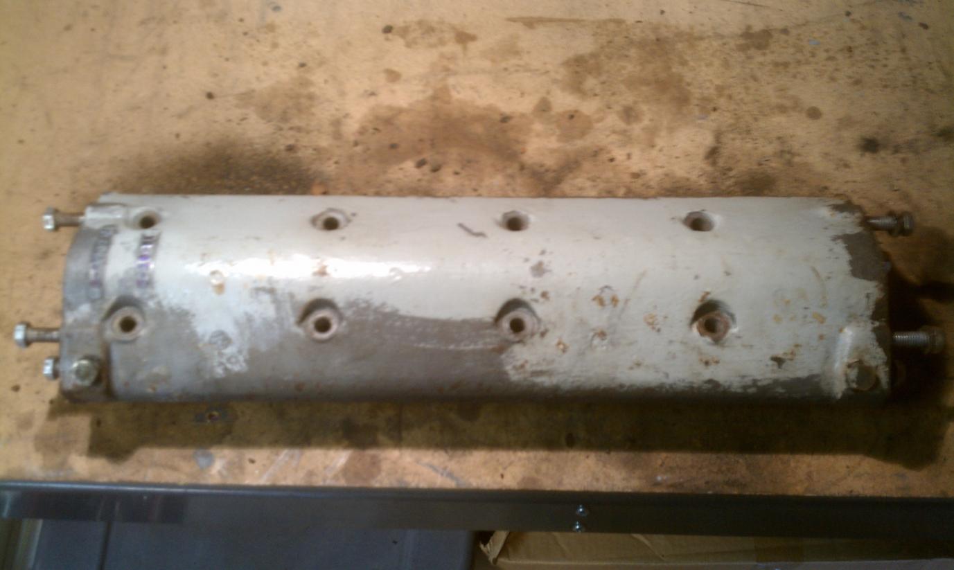

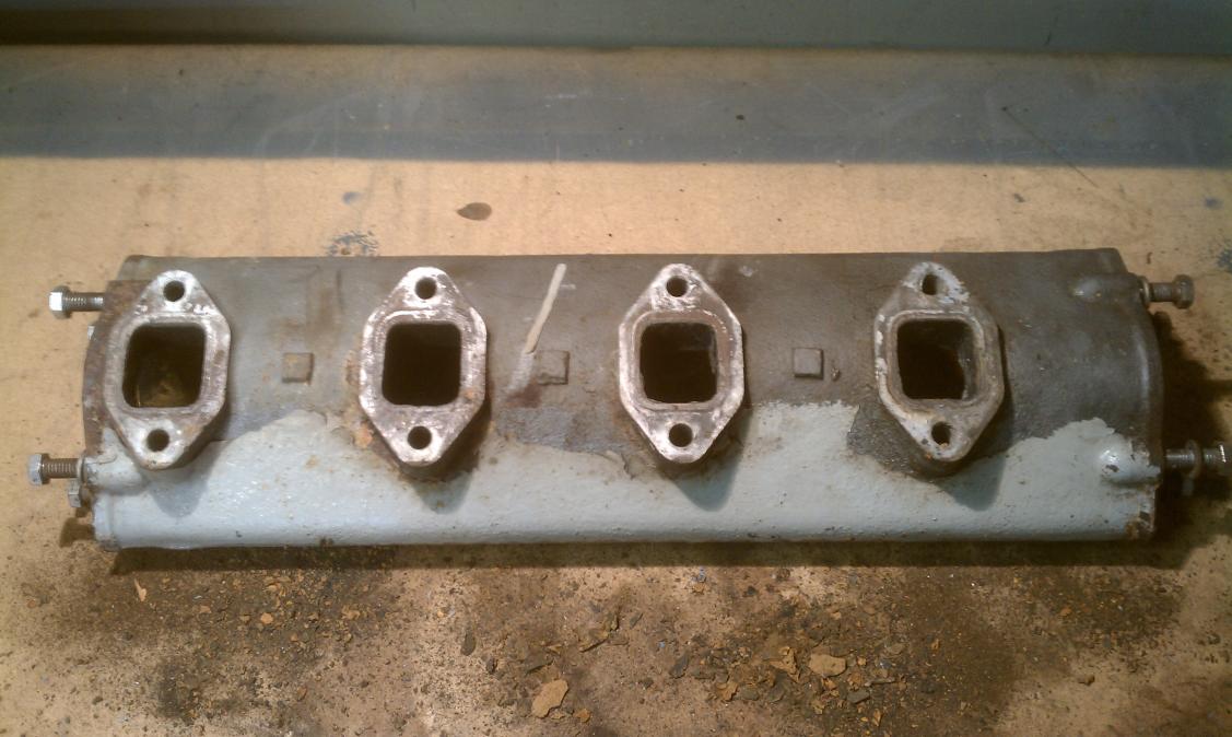

Some more info on the exhaust manifolds:
I found these numbers stamped on left manifold:
B-5799-M
5-18-84
My assumption is that this is the part number and date code of the casting, but I can't find any reference to it online. This was the "good" cylinder bank-no water or misfire-but one of the main water paths was completely blocked. So, I need to replace both manifolds and end caps. I've included a couple of pictures of the manifold in question.

That may be a barr marine number on the manifolds B-5799-M and the other looks like the cast date back in 84.Im not positive but there may have been an auction for some on Ebay within the last week or so
Anycase try to find Barr marine as I have never seen Osco offer those
