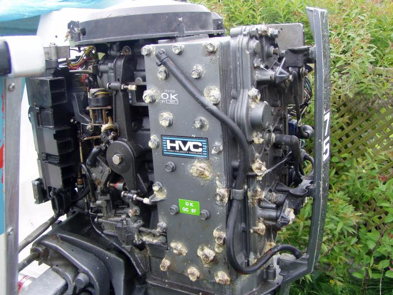

Hello Tony,
Thanks for your reply. I've had another really good look and still cannot find a serial number anywhere. There is a round 'hole' about 1cm deep in the area you describe in which a Welch plug might have been fitted at some point, but just 2 digits in the hole. I've attached 3 pics to this message. Is there any chance of identifying which model it is and the approx age, please? I've tried searching for what I assume must be the part numbers in my first post, in the vain hope they would be a clue to the model, but nothing comes up.

around 1987-88 with the split cowl. They started making this model in '87 to replace the L6 tower of power. Bucket cover is '88 & up.
Time bandit is mostly right... That model did indeed start in '87... But the bucket cowl didnt come out till '94 for that model...
I can clearly see where the ID tags should be and they are not there...
The Light grey colour tells us its '91-'93... but the rear cowl support is the darker colour which is '87-90..
That powerpack was first used in '94..
The split cowl was used '87-'93..
My best guess would be that its a '91-'93 with a later model powerhead fitted...
How many wing nuts hold the flywheel cover on?? 3 is pre '93 and 4 is '94 and later...
What are the WME numbers on the carbs??
