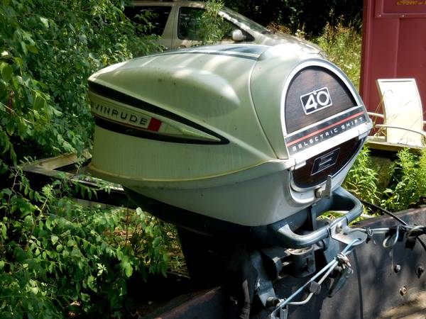

A pic is attached(I think). The model# is 40662B, serial# E01488. So this is a Bigtwin not a Fastwin. Curious that I see separate parts catalogs on e-bay for the bigtwin and the lark, which includes the model # of this engine. Do you know anything about the Lark series?

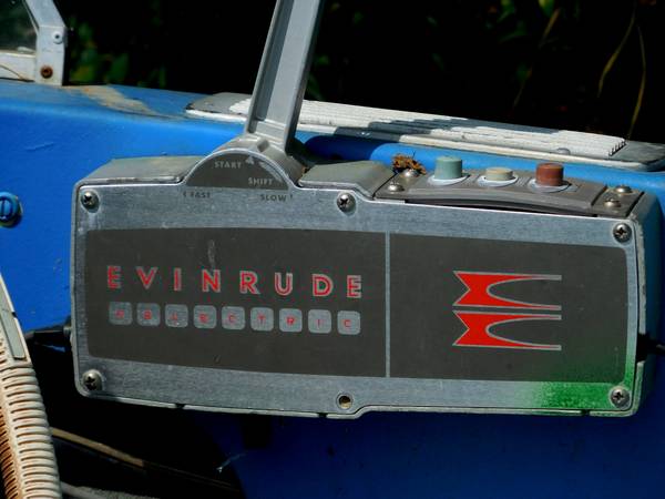

The ---LARK----Was simply the deluxe model with electric start and electric shift.-----------The electric shift scares most folks but they are very good and reliable !!-------------But you have to have the controls for it to make it all work.-------Amazing how these controls get seperated from motors when they are sold.
I think everything is there. The engine is mounted on the boat, all attached and connected. There is also what I think is the junction box which i assume has the solenoid and fuses in it. Great info, thanks!
