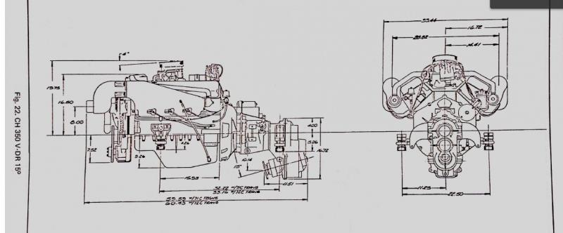

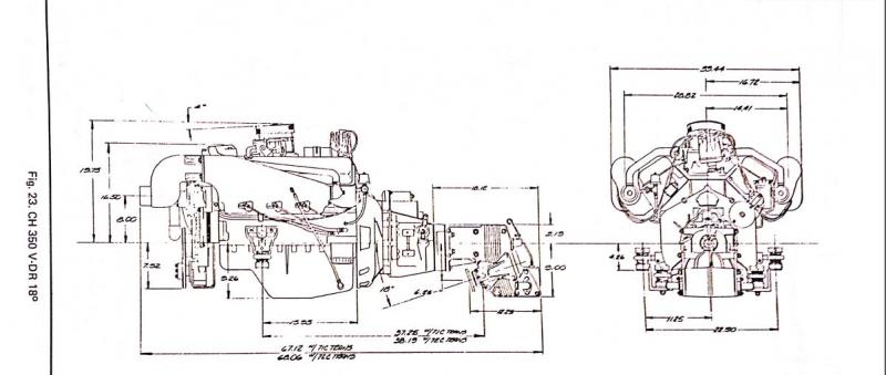

Model CH 350 (454)/ V-drive installation drawing needed
I don't know if you are going to find any drawings from the CH350 timeframe....I have some of the newer ones 454XL/XLI timeframe...in order to get the correct drawing, you'll have to be a bit more specific about the V drive being bolted to the flywheel cover...
Here ya go.. these attached scans are from the Crusader v8 Technical Manual, roughly 1976 vintage. The previous owners of my boat kept all of the original manuals.
There are two models described for the CH 350, a 15-degree and 18-degree.
I had to cut the scans down because this site has a lame limit of 400k per attachment, but they should still be readable.
