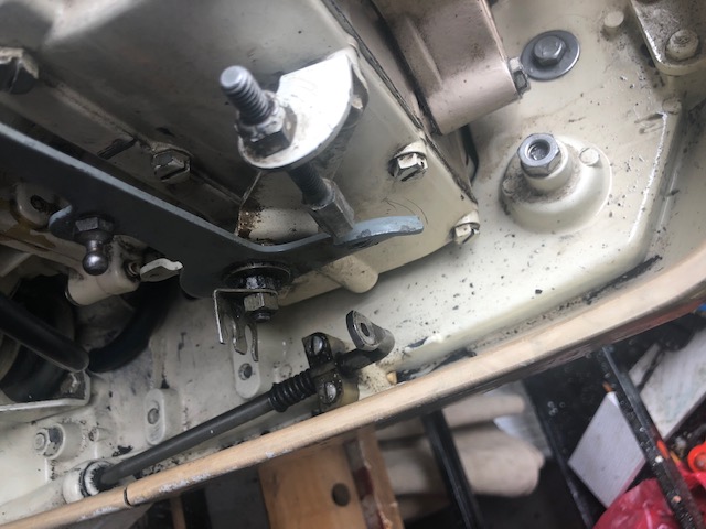

Looking at the throttle linkage I seem to be missing something. Can someone have a look at the picture and let me know what I need?
Maybe it's something I can make......
Thanks!

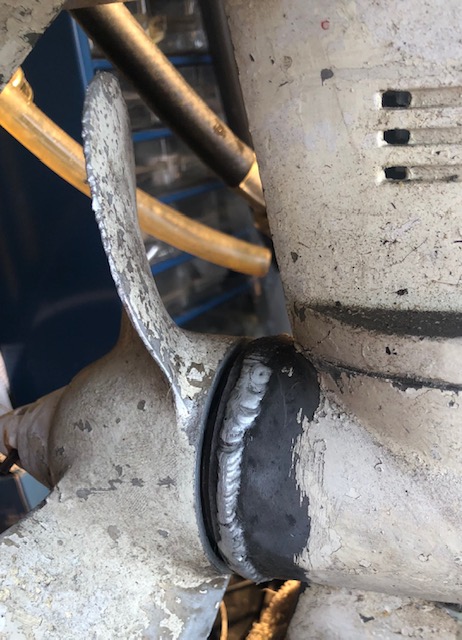

Have a look at the attached picture of the gear housing and the weld around it. I assume this was done to correct a crack or something....anyone see this on a motor before? Is this a legitimate fix or destined to fail?

Wow good weld job!!! That's a new one on me.
Clean it up and paint it.
The linkage pic: couldn't really tell, maybe a few more from different angles??
The center of the pic is a ball connector, the end of the cable snaps on there,
where the cable comes through ??? More pics.
Franz marine they have access to older parts and diagrams.
iboatsdotcom their Force repair forum, Guy on there from Sweden. Nordin works on older stuff.
Mastertech Marine they might be able to help?

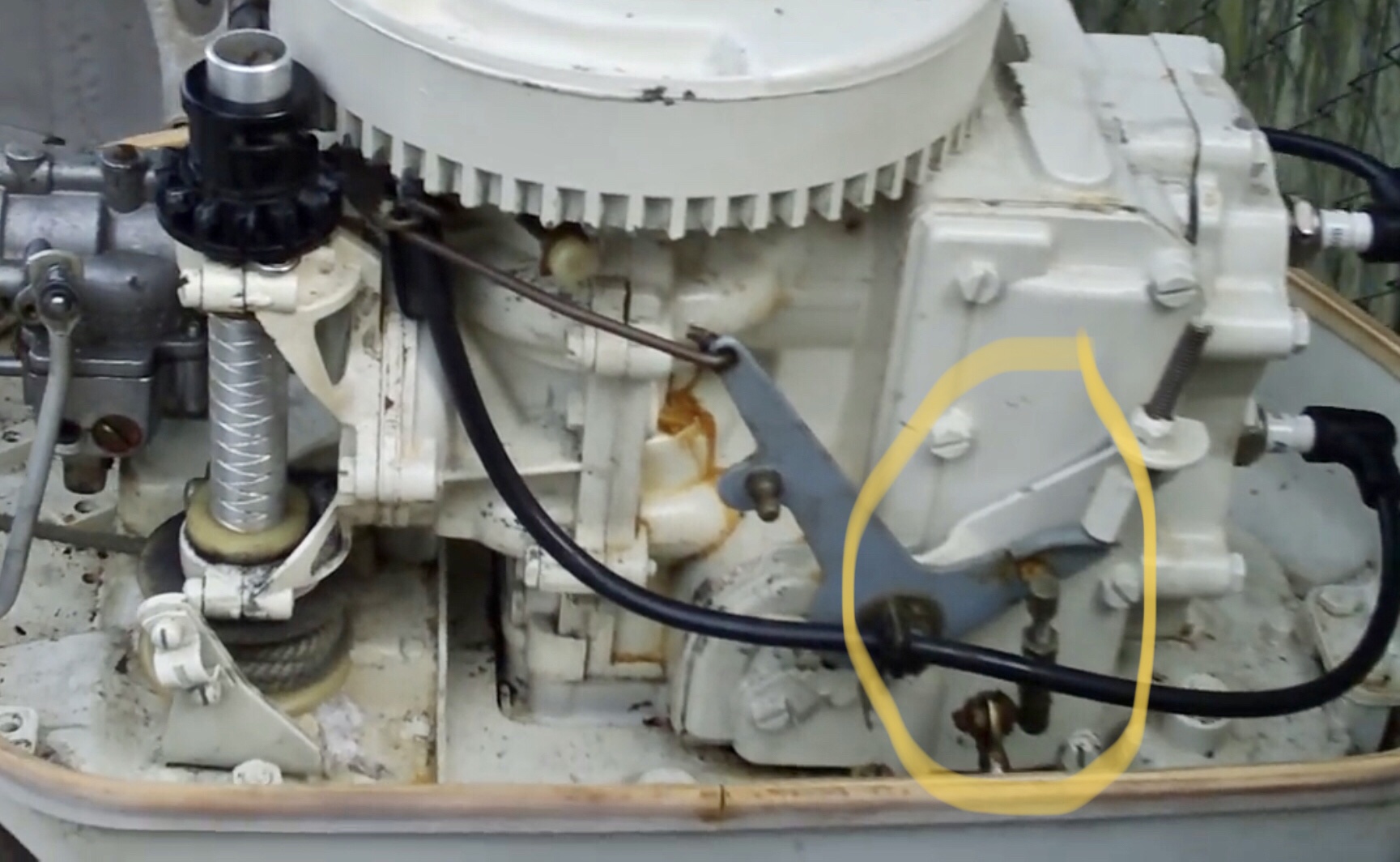

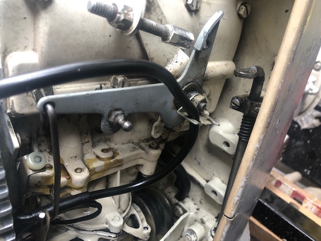

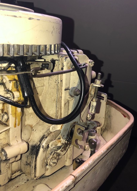

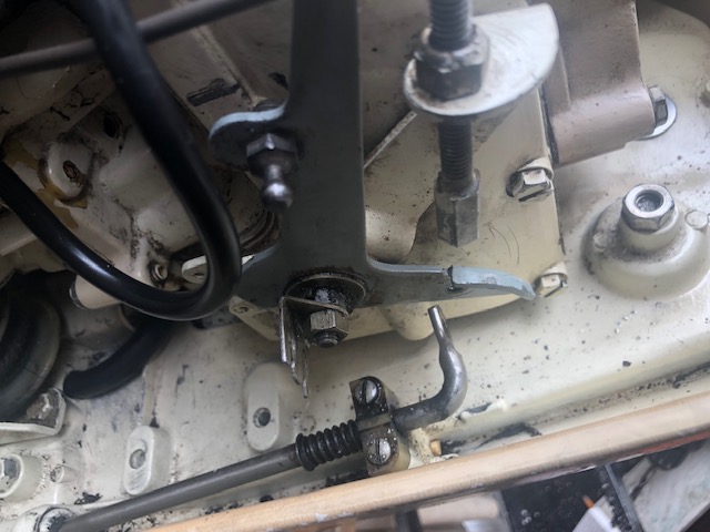

Attached a few more pics with a couple of angles. I also attached a pic I was able to screen shot from a video of the correct linkage.
The throttle control rotates and adjusts the lever up/down connected to throttle plate. The throttle plate/lever seems a little stiff when I move it by hand,
Thanks.
