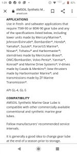

Here is the best stuff available. It has been tested with up to 15 percent water....still exceeded specification/requirements with 15 percent water. Also it is compatible with other lube should you introduce it to a partially drained unit. Screenshot_20210107-132924.jpg
