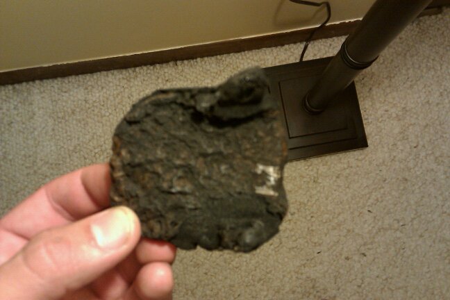

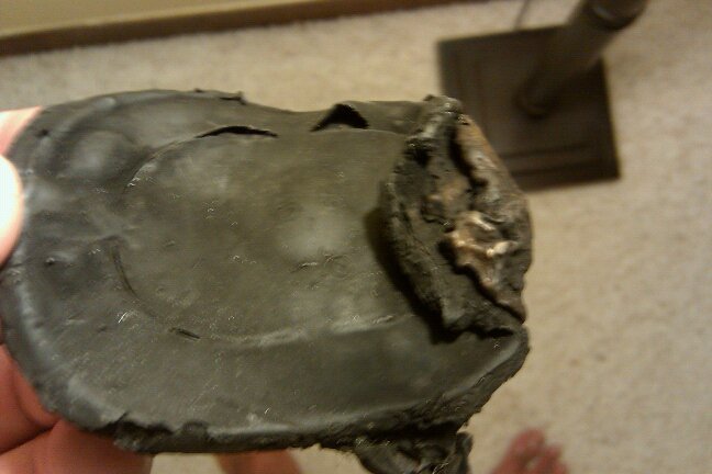

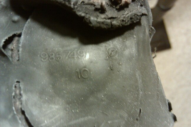

I removed the exhaust riser and exhaust couplings in order to inspect the flapper and install a new riser gasket as preventative maintenance.
The riser unbolted with out a problem and inside it looks very good. The old gasket was not leaking, but was rock hard and "petrified". It took some extra effort to scrape it off the surfaces.
When I looked for the flapper, all that was there was the shaft on which the flapper pivots. The shaft was in good condition. I got a flashlight and looked down the exhaust connector that goes to the outdrive. Didn't see anything.
I poked around with some extra long needle nose pliers, but came up with nothing.
Two things come to mind:
1. Some mechanic removed it for some reason.
2. The flapper was exposed to raw, uncooled exhaust gasses and melted off the shaft and is wadded up somewhere down near the outdrive (have not removed outdrive yet).
I have never seen a flapper, only in pictures. I have no idea of what material they are made. Someone with experience clue me in on the material and what could have happened to the flapper?
Thanks.
