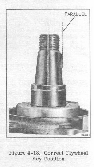

The key must be installed perfectly straight with the engine (vertical), not aligned with the crankshaft taper.
