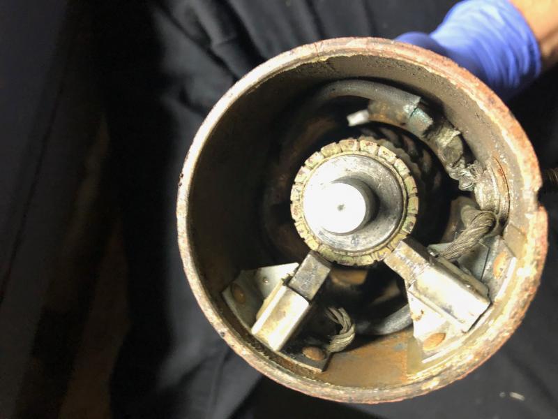

So I popped off the bottom part of the starter motor to get a better look. How do these brushes look? I don't know what they regularly look like. They seem to be pushing up against their contacts pretty well, so I'm not sure how that could be the problem, but like I said, I don't have any experience with this.

Looks like a lot of brush left to me - what do the other ones in the cap look like, how is the continuity between the field windings and a brush - it should be 0 ohms.

They look fine to me too. I suggest you clean up the commutator with fine sand paper, oil the bushings (top and bottom) and reassemble. Oh, and be sure the brushes move freely, with lots of spring action, so they don't bind.
