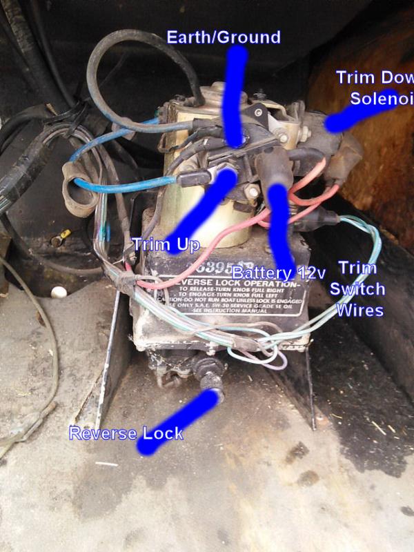

Sounds like you have air or shortage of fluid.I'm going to hazard a guess this is what you've got.
With the motor full up, the fill screw and the vent screw,small screw above the fill screw, open and fill with fluid,operate the trim up and down,check the oil level and top up.Repeat until the level stay at the bottom of the fill hole screw threads.Oh and make sure it's the same oil/fluid as what's in there.
Make sure the knob is turned full CCW,or full CW to lift engine manually

It was short on oil and I filled it, ran it up and down several times. That slowed the downward drift down significantly, but didn't stop it. So unless there is residual air still in the lines, which is possible, oil shortage isn't the fix for my issue. I checked for leaks, but didn't find any which doesn't make sense because the oil wouldn't have just evaporated. I'm going to look for new units, but have a dumb question. As long as the hose connections are the same size, I should be able to replace my unit with any comparable aftermarket unit right? (in case the correct part number isn't available). Most likely, I'll rebuild the cylinders first though as they are on the outside and easy to access. Thanks for the advise!
Took me almost an hour to fully bleed my system after installing in boat and I had system completely drained,hoses disconnected.These are a straight forward pump,plenty of O rings to replace on the rams,if you have the Seloc manual page 9-11 has the sizes required.Copyright laws prevent me from posting pic. https://www.ebay.ie/itm/Mercury-Mer...Relays-USED-/233627483944?hash=item3665487f28 For illustration purposes only,I have no connection nor do I know the seller,but this is what you need if replacing,but I think the rams may need a few O rings as well,but try running it up and down a couple more times,making sure the reverse lock screw is turned full anti cw/left
