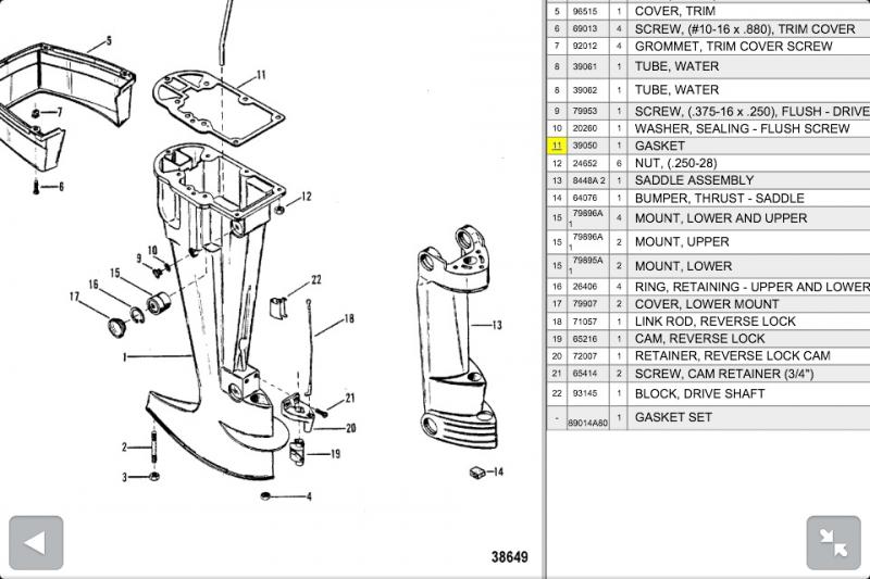

theres this link rod on the outside of the driveshaft assembly and looking at these diagrams it reverse locks? Should I do something about it? (#18-22)
Does it unlock in forward gear? If so dont mess with it to get to 18-22 you need to remove the powerhead and completely disassemble the swivel bracket and driveshaft housing.
Motor is off and in neutral and the link rod moves forward and backward so it works but unsure of how to tell if it's locking or not
