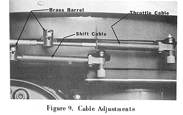

The piece right above folds down and lock the cables in place.----But it might be broken.-----Couple of zip ties work if you are on a time / $$ budget.
Those cables don't appear to be adjustable like the Mercury ones and that orange anchor might not fit into the clamp.
Example of the Merc cables.
