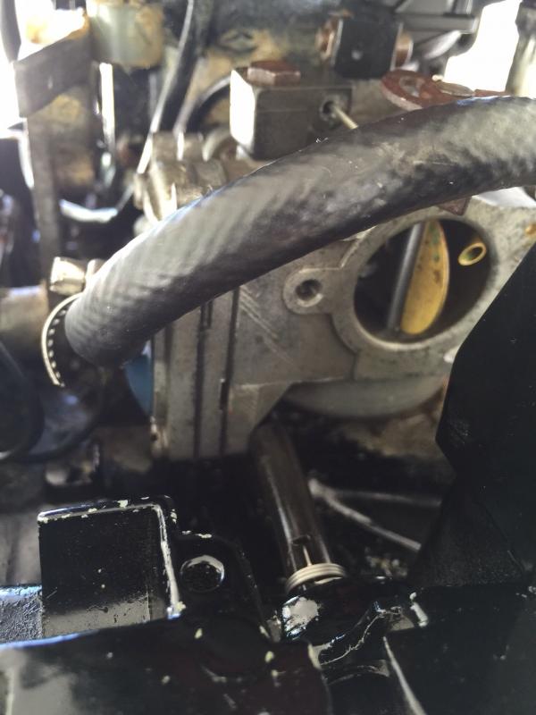

Can you post a photo of the fuel pump?

Sure
Here are a couple of the pump

All bets are off; that's the later carb with a good set up.
The vacuum to run that pump comes in right from the crankcase via a small hole in the intake/ carb gasket. See if that hole is open and the gasket is sealing it properly.
Jeff
Jeff
Thanks Jeff, When I pulled the carb I found the issue. In the computer biz we refer to the problem as "an issue between the "seat" and the "keyboard". Basically user error!!!!
I installed the flange gasket upside down blocking that little hole :mad:. flipped gasket around and installed starts right up and runs forever, no pumping of the bulb. appears to be pumping gas like a champ!!!! I am sooooo grateful for you guys making me re-check my work.
