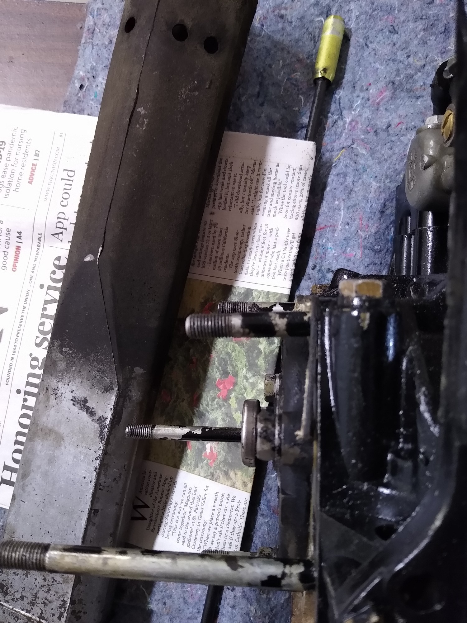

Quicksilver, thank you for your quick reply. I removed the exhaust extension plate. I don't see something obvious on either gasket but will clean the surfaces up and replace both gaskets. I did notice one of the studs seems a bit out of square. I can't seem to upload photos.
Are the stubs threaded into the block? I can replace it or try to bend it back into square. Thoughts on this?

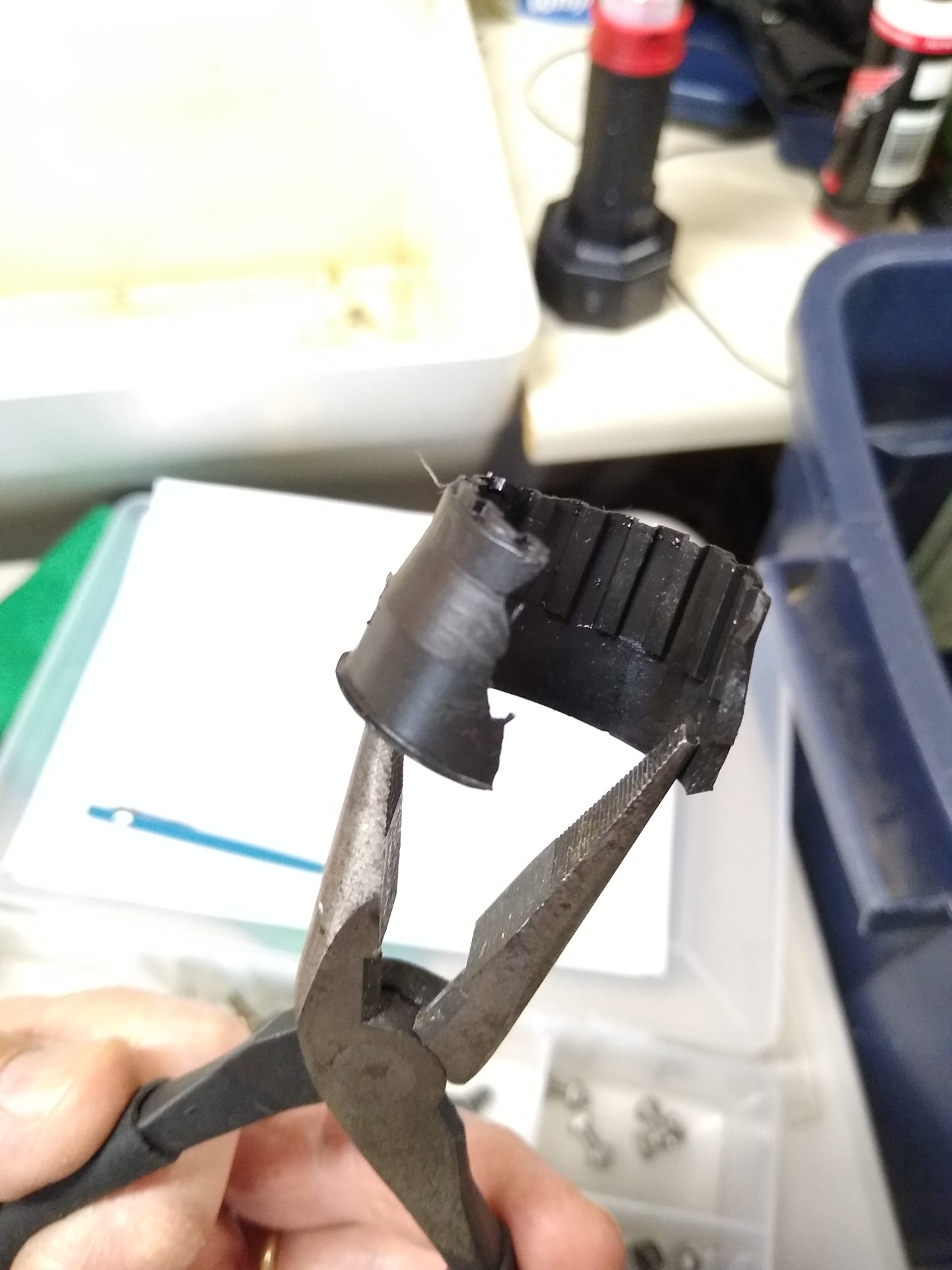

When I dropped the LU, several washers fell to the floor as well as an interesting looking rubber bushing. I’ll try to post pictures but I’m not sure where it came from or where it should be installed. Any clues you can provide would be helpful.

The studs that attach the powerhead to the exhaust extension plate are threaded into the base; I have had white goo on my driveshaft and the manual says to fill the LU then drain 1oz out, you might have a bad seal under the waterpump which could explain the water filling. Rebuilding the lower unit requires the use of a bearing carrier toolbearing-carrier-toolsmall.jpg that is available from Mercury

Here's the slightly bent stud. What do think about trying to bend it back with a pipe while protecting the threads?

Here's the rubber bushing piece which fell out when I removed the LU. What part is it and where does it install? The 2nd photo shows the ribbing on the interior.
attachment.php
The ragged edge at the top of the bushing in the photo below seems to say that there was a section ripped off.
attachment.php
The piece seems to fit the splines at the top of the drive shaft.

That torn rubber piece fits over the driveshaft splines as a seal, when it's new; the tool is used to remove the bearing carrier nut at the prop end of the LU which lets you remove the internals. I don't know if you can straighten out that stud but if you have a straight one lying around go ahead and replace it. If you use a LU oil pump you can pressurize the LU and see where it leaks but since there was water in it I think all the seals should be replaced and you can check for bad bearings and rust at the same time. Use the serial Nr. to locate parts.

Quicksilver, if I understand, that rubber piece is not needed but was there to protect the spline when new, correct? I like the idea of pressure testing.
