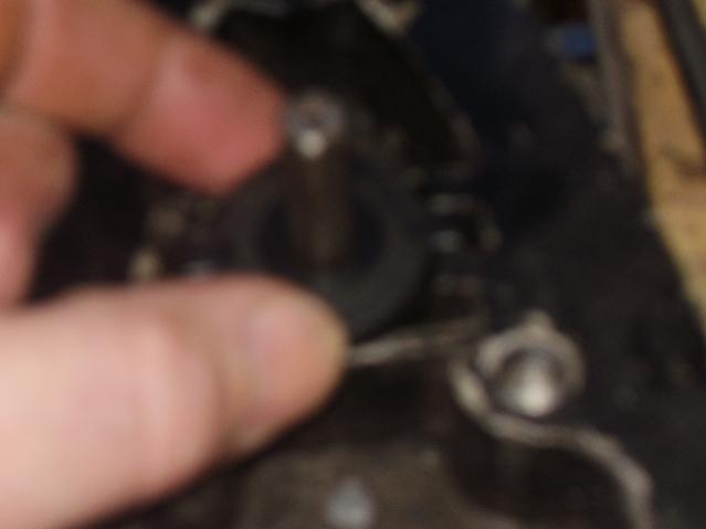

Hi, I am having a problem to put the lower unit back together, which is the correct way to install the reverse lock cam and in which gear it has to be to get it back together? my service manual is not showing the way it has to go in
please help
thanks anpeter
Install the cam in neutral,then as Jeff says put both in FWD and away you go
