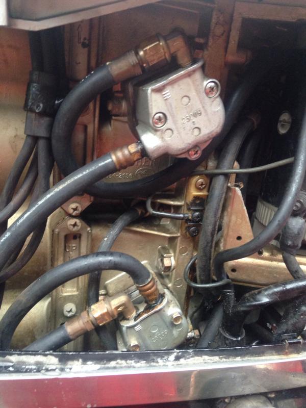

What's up everyone. Got a mercury 65 how motor. I had it running and it stalled out. I found out I'm not getting fuel. My question is about the fuel pump. I put new a diaphrams in. I have fuel all the way up till where I put the new diaphram , I put some gas in the carb and it fired right up. Here's where I put my new gasket and diaphram. The top one
For some reason the pictures won't load.

No I haven't jeff. Is there a way to test them. I got fuel all the way up to the pump. I took off a hose and poured some gas in the carb. It fires right up.
I checked them. One lets fuel in. One lets it out. Everything seems to be working there. Gas is flowing through there. It's not clogged. I'm attempting to blow out the carbs cause removing them means. The distributor and starter all have to be taken off.
I found if I pour fuel straight in the carbs. It fires with no hesitation. The carbs aren't leaking fuel at all. Perhaps one of the needles is clogged.
