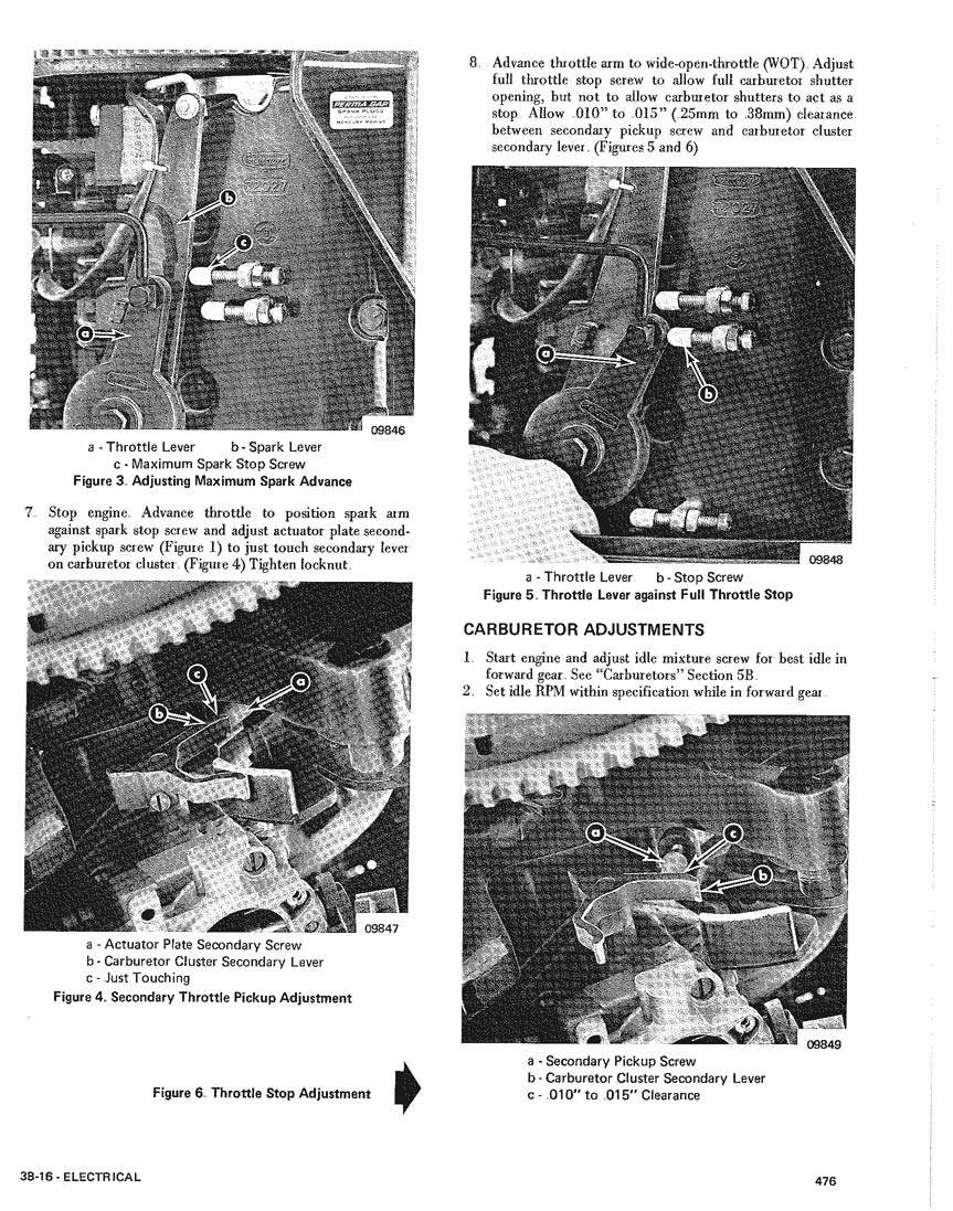

When my 1977 Mercury 500 runs at full throttle it seems to me to not be wide open. If I back off my throttle stop screw to get more RPM's, do I need to do anything with timing as well?
I used to get 30MPH on my boat but after a trip to a mechanic to help me solve leaking carb issues, I am only getting 27 MPH and the RPM's don't sound as high. The mechanic told me timing was way off. He adjusted timing. The engine does run and sound good, just not the throttle I am used too.

The only reason I can think off (that the motor is happier at less throttle) is that the timing is too far advanced.

Before you start guessing what's right use this procedure
Thanks you!
turned out my bottom carb was leaking at blue plastic inlet. Has to remove carbs to fix. Now she seems to be running pretty well.
