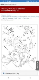

I just bought a Mercury 40hp 2 stroke 2cylinder seapro.
Now i have noticed that when at idle my motor runs on 1 cylinder .
I have pulled the top sparkplug wire and still runs the same . I have change the sparkplugs en switched the coils. Still the same result.
Now i have noticed that when i pull the sparkwire from the sparkplug, i still hear sparks in the cap so it does spark..And when i pull the top sparkplug out it,s greasy and darkblack (to rich in fuel) . And the bottom sparkplug looks good. Also it smokes heavy until 1quarter of gas. From 1quarter gas till full throttle there is no problem and runs great.
What do you guys think it is.
1, reedvalve
2, condensator
3, stator
4, something else
I just wanna know so i can import the parts and replace it . But i dont want to buy the wrong parts
