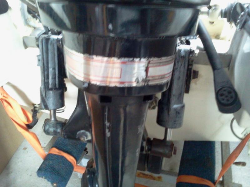

Also, do I have something good? I know it is a 67/68/69 model...just really curious what I lucked into...

This is the type of PTT that goes on the older Mercs.You can change the rams and with a bit of imaginative thinking add the rams and brackets without changing the saddle and swivel clamp. https://www.youtube.com/watch?v=9NZgEmX1TWQ. I did it without changing the saddle until I swapped it to another boat.Bottom pic is before the swap,and saves a lot of hassle.
Pump sits inside the boat.
There should be a number on the swivel bracket,older than '68

Any idea where to find one? I've seen numerous models, but not a complete setup...
