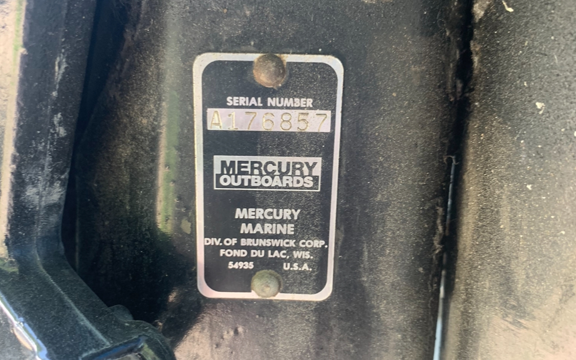

Hello, I have a 9.8HP Mercury outboard model 110 with S/N:A176857
I have been trying to find info on this engine, I am needing a service manual and some parts for it.
This engine runs well but It dies every 20 mins or so at trolling speeds and I need to pump the primer ball to get it fired up again, I am assuming this is the fuel pump but I cannot find any info on this exact S/N
Any help would be greatly appreciated.

Probably the worst photo on the planet but the only one I have of it unfortunately
Sure it is a 9.8 model?---Any pictures ?
It would appear to be a 80s model 9.8HP Mercury but no luck on a serial number on my end and I have done quite a substantial amount of searching. This is not the engine but appears to be identical in visual appearance, I do know it is a long shaft
