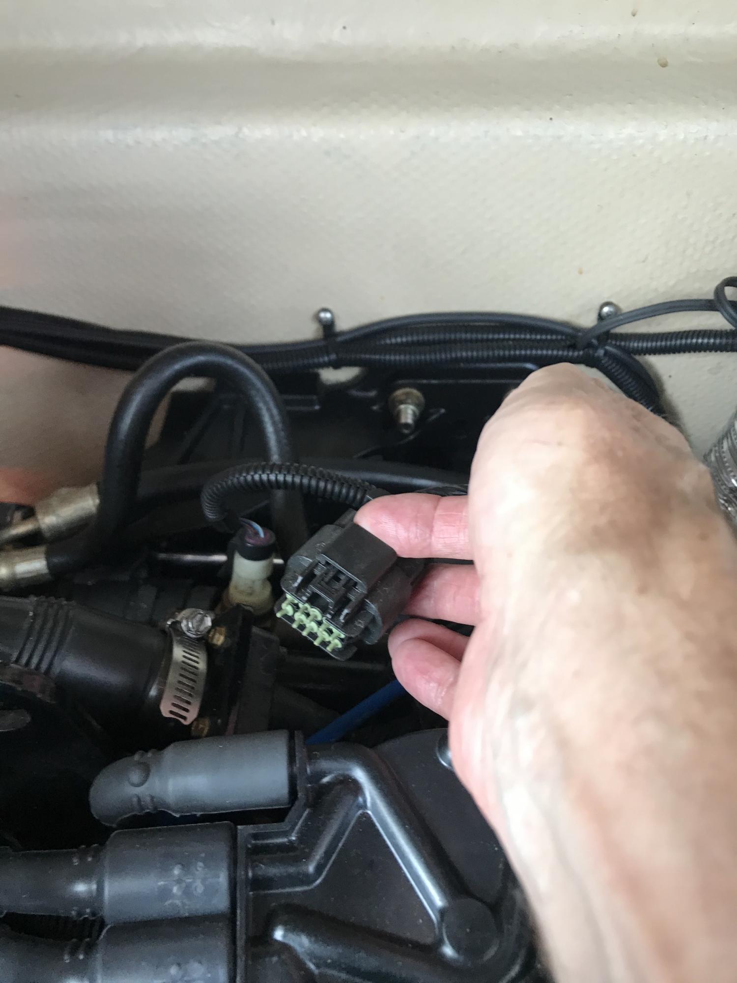

I'm trying to locate the "10 pin connector with resistor" to connect the module. The only 10 pin one I can find has no cap, and is labeled "transom harness". I have a 2003 5.7 mag in the OM600000s. Any suggestions where I would find this connector?
I have a 2002 5.0 MPI OM3400000 and am also looking at Vessel View. I think I found my connection point. I believe the greenish looking thing is a dust cap only. When I remove the cap it's purple on both ends. This is the only 10 pin connecter I've found. It was hanging over the rear of the engine not far from the ECM. Hopefully someone more experienced will chime in. Appreciate any replies.
I wrote to Mercury Marine and heard from them today. They described the connector as being close to the ignition coil and after pulling on some wiring, I found it. It had a label of "CAN". Mine does not have the resistor, which they said is required, and they gave me the PN as 859318T1. Thanks Mark S., I'm sure you have found the correct connector.
